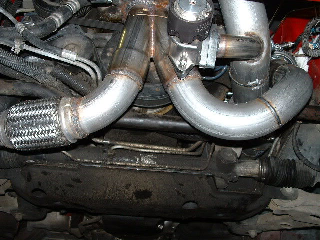

Here is where I put it on the last kit I did, this is a LT1 and some people didn't like that it was not in the middle of the y, but it will still work just fine and was most convenient for me.

Ya I am thinking of running mine by the 90 degree turn up on my log and dumping the gate back into the downpipe as well. Figure that way if anything needs fixn it's easy access Figure a Tial 38mm should hold up fine under 10-15psi on this 4.8
