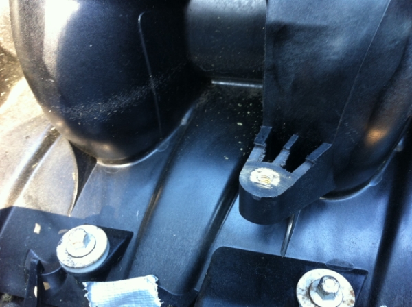

I'm running them on mine...stock fuel rails with stock truck manifold. They will not seat out of the box. I had to cut down the tabs on the manifold to make them work.

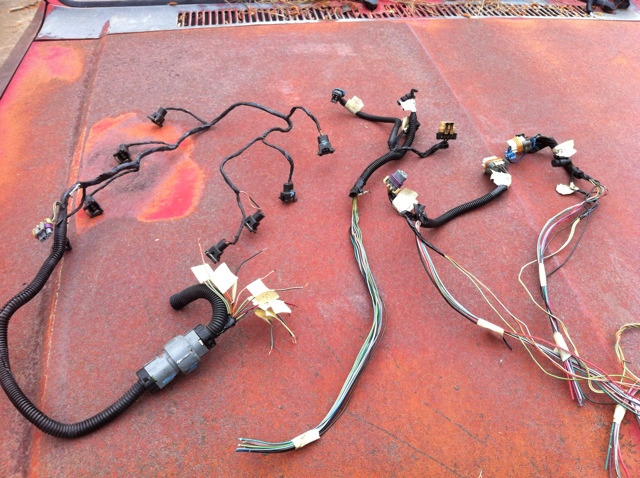

I also bought the harness out of a Northstar Cadillac with it's plug (on the left) which had the right injector connectors so now I can just unplug the whole fuel harness at once.

I'm more than sure i have the same injectors as you just buy the ev6 injector connectors online i bought mine at ebay for @ $10-12 and they have worked good for me... but what i did instead of cutting the intake use a piece of fuel/trans line and cut a little piece for each fuel rail bolt to use as a spacer for the fuel rails and buy the bolts a little longer...
