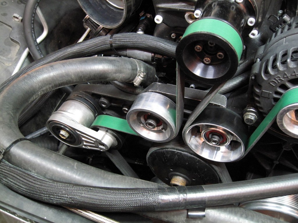

That could be fun, but just so you know, you can make the TVS HD tensioner work on a whipple, as well as the IW TVS stuff if you try hard enough
(that is mine)
(that is mine)
Who did you source these 8 rib parts from?
Old Jul 2, 2016 | 08:55 AM
Atomic's Avatar
I have a gauge for that
Posts: 16,282
Likes: 438
I bought the IW kit used, so the crank, alt, and power steering pulley are IW parts along with the left idler. The other idler is a metco 100mm idler that is needed to clear the whipple bracket. The tensioner is the gates HD one the tvs guys use, and I drew some spacers so I could mount it to the whipple bracket. That particular blower pulley is custom made, but I made an adaptor that let's you mount a tvs pulley on a whipple with the right offset and everything so you can use off the shelf tvs pulleys. It's all in my build thread if you want to look.
