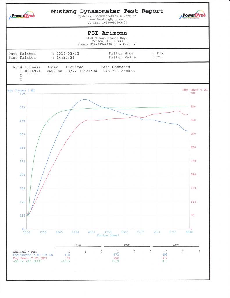

6.0 LQ Iron block
STOCK Rods, Pistons, Crank
STOCK 317 Heads w. springs, retainers
LS9 Gaskets
BTR STG 3 Blower Cam
2.3 Whipple @13 lbs boost
E85
18° Timing
SMOKESHOW TUNED
Mustang DYNO
4l80E Trans w/ UNLOCKED converter (Yank SC3000)
Ford 9 Inch w/ 3.70 gear
VIDEOS
https://www.youtube.com/watch?v=w09XbX93JxU
https://www.youtube.com/watch?v=t-ic...ature=youtu.be
GREEN = Boost
RED = RWHP
BLUE = RWTQ

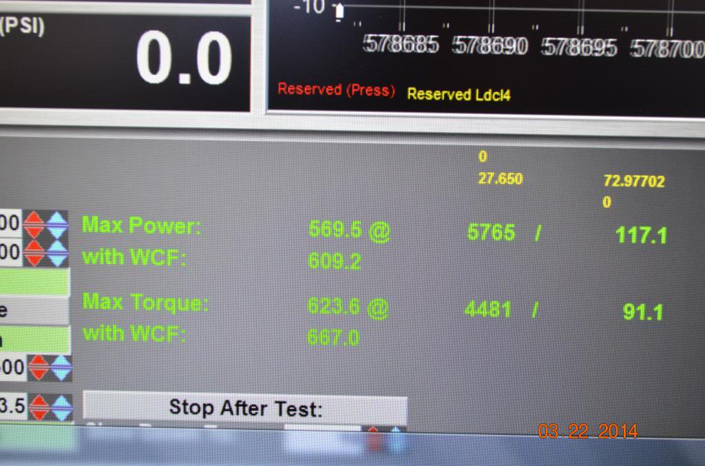

LAST PULL

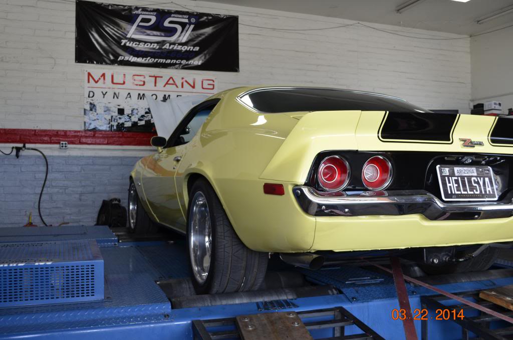

Hellsya nice ride! Simple combo with great results.

Very nice car man. The lines on that body style make me ... well I won't go there. Is there a build thread on your car?

Nice numbers!! Did you try pushing the timing past 18?

Congrats , that's a badass looking car , love the wide meats on the back .
What is "WCF" ??? Some type of correction factor ?

Ya Tim, WCF is with correction factor.
Yes. Didn't like more than that. My SCR is ~10.5:1.

You'll notice a couple small dips in that dyno graph where it started pulling timing. 18° was about all she wanted.
My truck only put down an extra 30hp on this dyno at 21psi....she's a stingy bitch.
