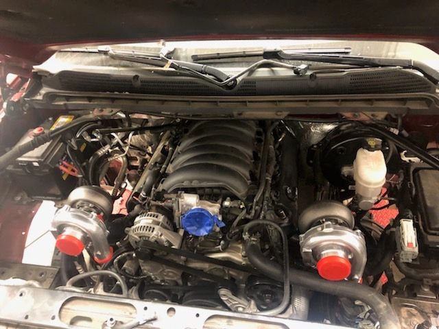

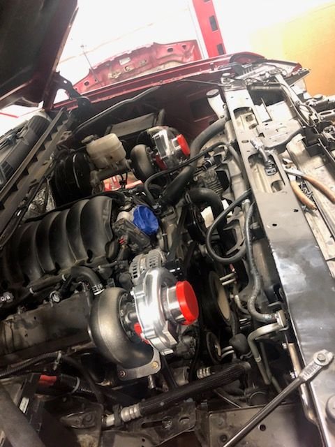

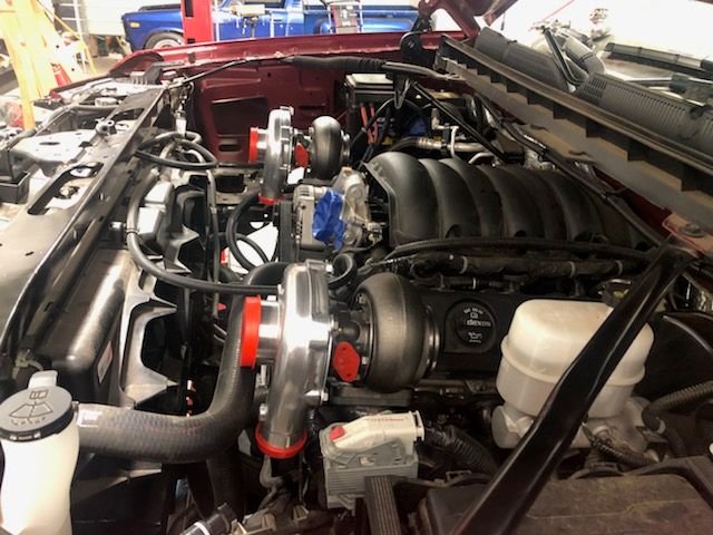

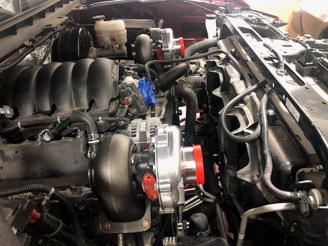

Rick has worked tirelessly on these. He reconfigured and relocated them several times to get them as close to perfect as possible...square, level and the absolute least interference possible with everything under the hood.
He is a perfectionist as many of you already know.
It's still in progress but looks like the hardest part is accomplished. I'm heavy into my AC business's season now so it may take me a while to get on the road but I'm really looking forward to this. Made in Texas! Thanks Rick!

Thats gona make for a fun ride right there!! Cant wait to see it all complete and going. Keep the pics coming

OH boy! Those look like a fun set of twins to play with and they probally cost less than the last set I had...

Probably less lol! More fun not sure? Oh the memories!
I wish I could say this is gonna be a quick project but it won't be. I'll likely end up installing it at the end of AC season unless I'm blessed with a killer year then I'd just have a shop do it. But I hate to. I'd like to do it if I have time. Either way 5.3 to start probably and in a year 416 is looking pretty good. No hurry at all because I've always got the red whip to play with daily.
