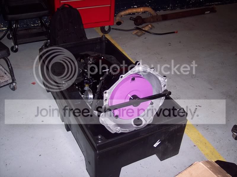

Old Dec 18, 2006 | 10:56 PM
1SlowHoe's Avatar
Destroyer of Transmissions
iTrader: (28)
Joined: Feb 2005
Posts: 4,962
From: Orlando, FL
Dr X, Wheres your tailshaft housing? lol.
I got a pic like that...

Old Dec 18, 2006 | 11:22 PM
DrX's Avatar
DrX
Joined: Jun 2005
Posts: 2,703
Likes: 6
From: Canada
Nice colors.
I'm 4WD. T-Case adapter bolts up to the back end of the trans.
