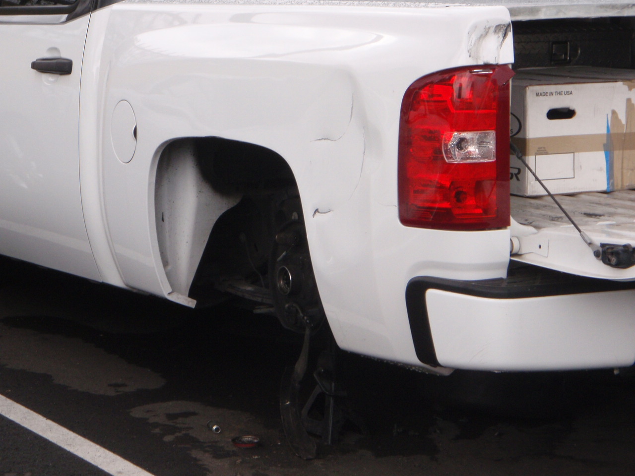

Oh before this came about, I shortened rear end 1 1/4 on each side, 410gear, custom ground cam, trip springs, roller rock and lift, cold air, pacesetters long T, hi flo cats and trans (4l60e) completely gone thru. Your probably saying What, 4L60?? My trans guy knows what Im doing and still gave me a 1yr warranty on it and he swears it will be ok. We will see.. 07 silverado on3 turbo kit-20140710_192228.jpg
Oh heres what happened 200 miles after mods were done, broke an axle..
