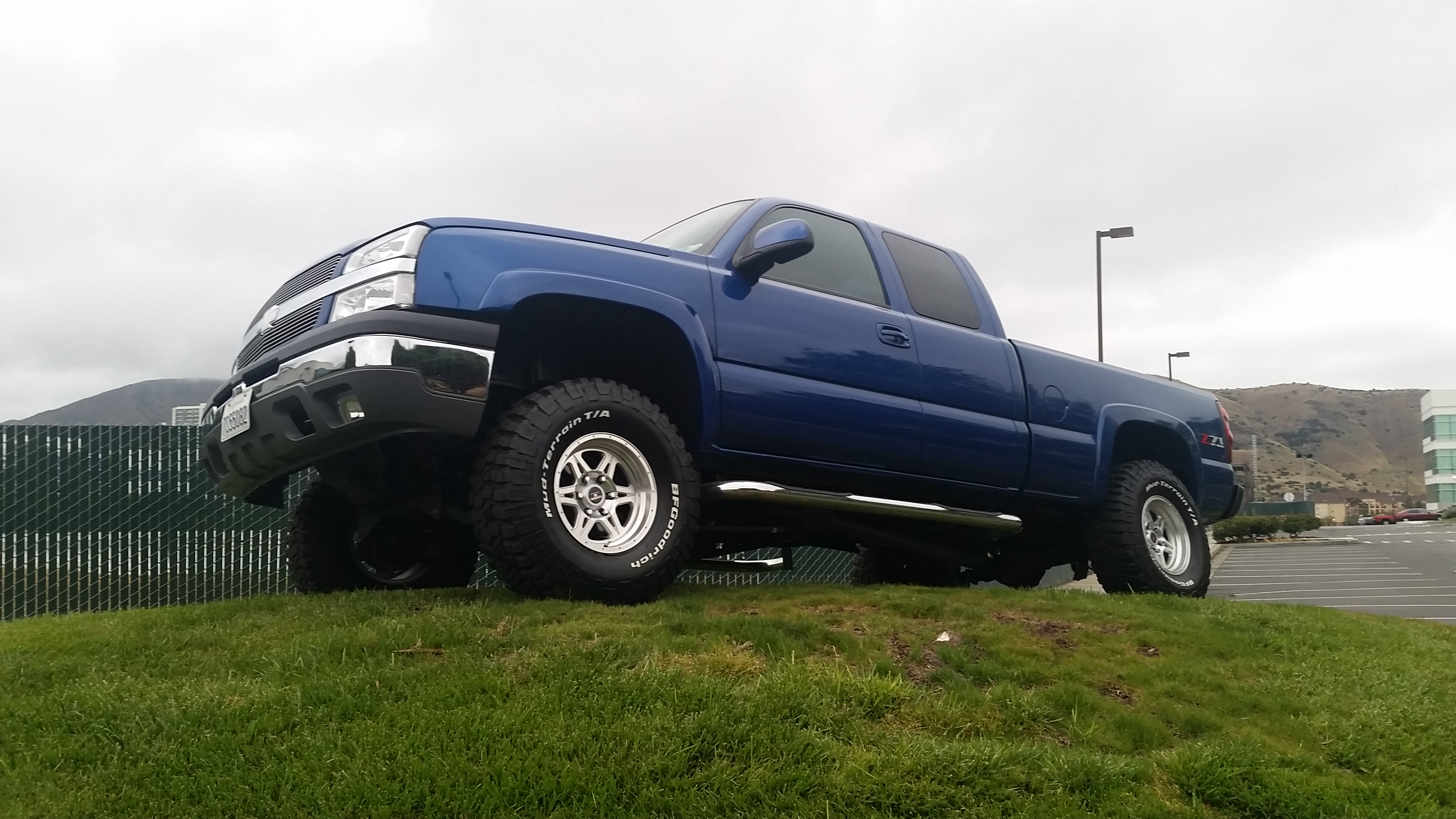

For my dad's birthday I'm going to be super charging his 04 4x4 z71. Truck has 42k miles and I already lifted it and did intake/cat back set up on it.
Since I'm in california I want to get a smog legal blower for him. 91 pump gas no meth.
Looking at edelbrock or whipple or magnaharger. Any 2300 set ups that are smog legal?
Thanks guys
