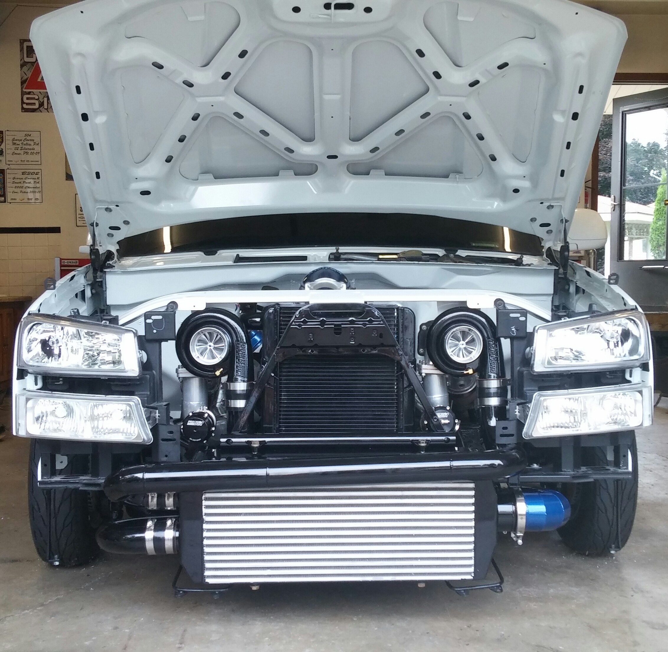

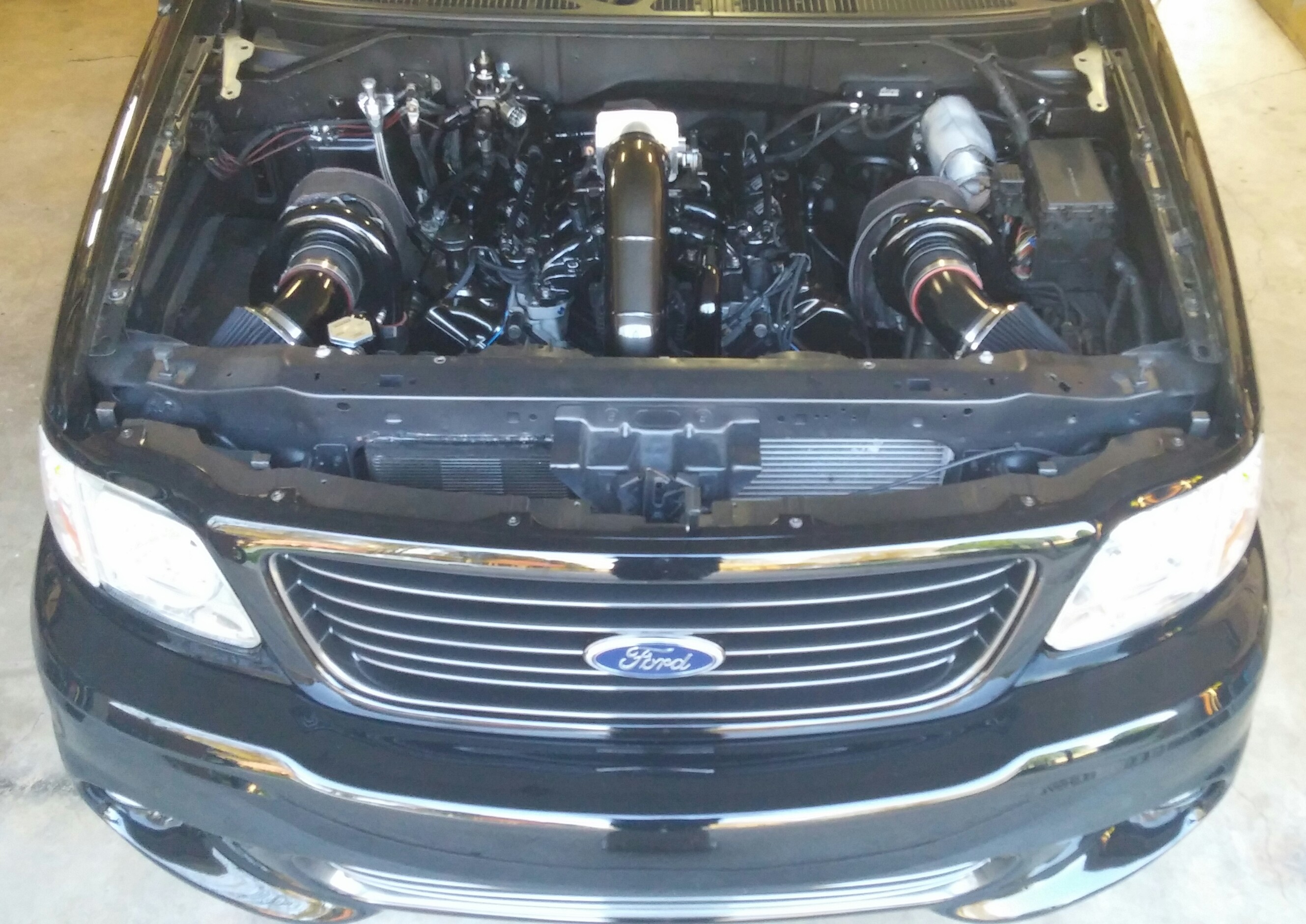

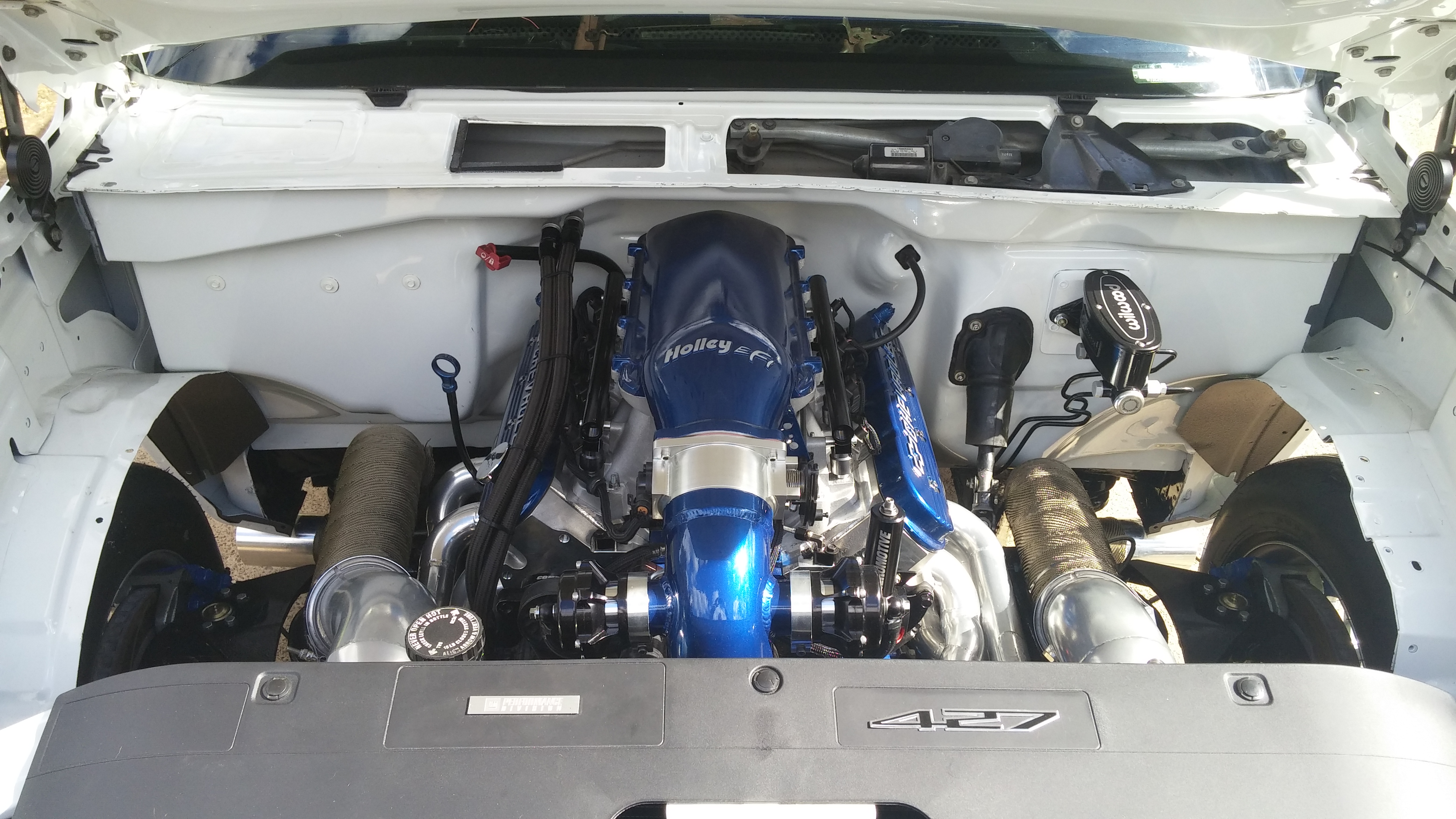

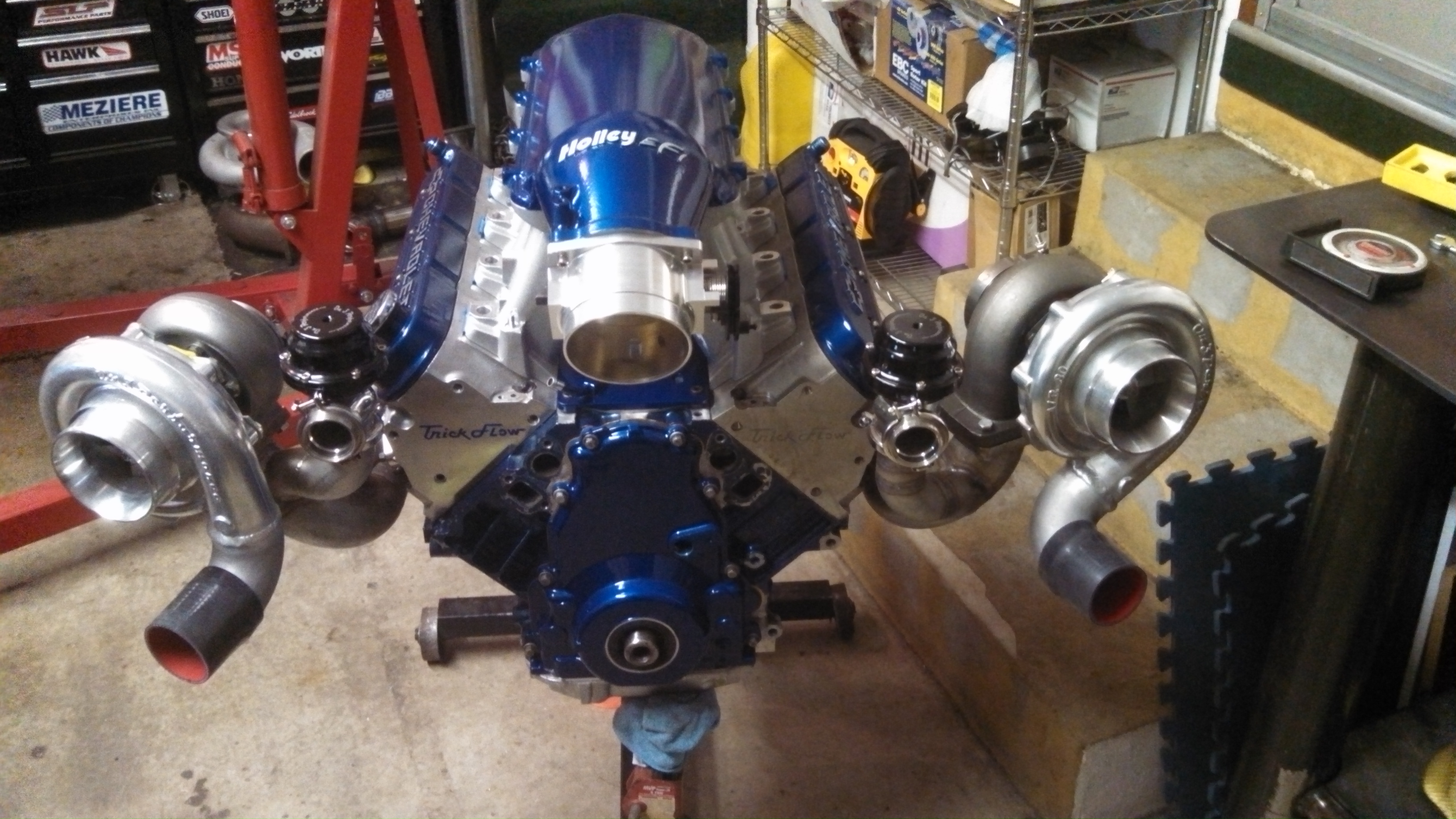

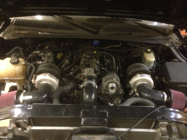

Few twin setups ive done
Attached Thumbnails lets see some twin set ups!!!-8be65df9.jpg   lets see some twin set ups!!!-0503151920a-1.jpg   lets see some twin set ups!!!-img_20131125_191836_618.jpg   lets see some twin set ups!!!-0807151840-1.jpg   lets see some twin set ups!!!-1016151342.jpg
