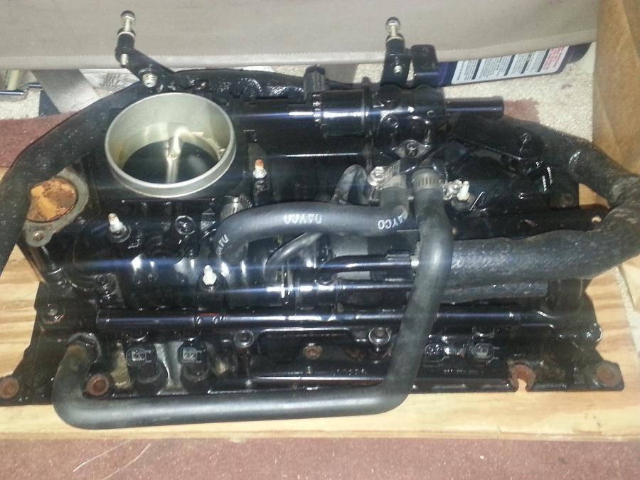

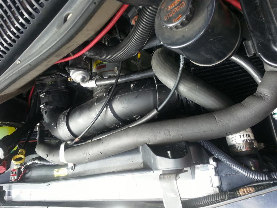

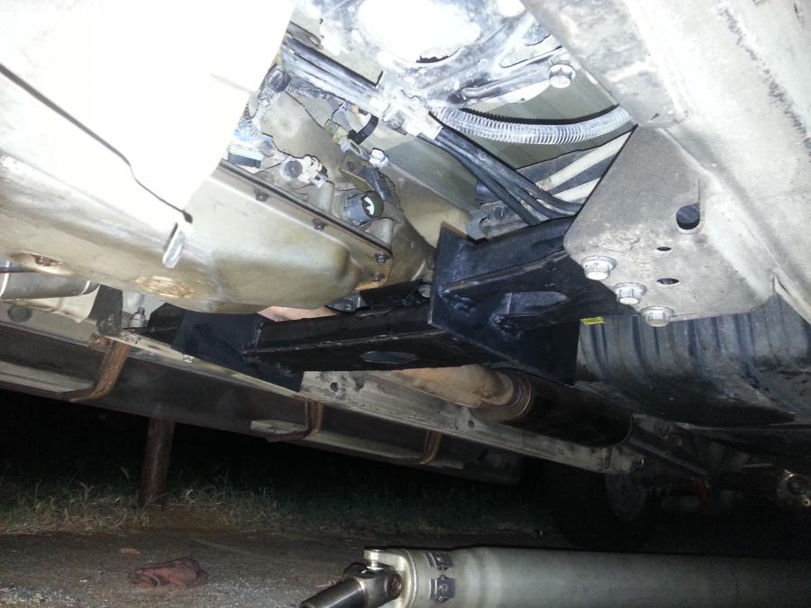

Someone swapped cams to a mild Comp 4x4 XE based torque cam, added a home depot CAI, and switched over to the marine L31 intake. Since the previous dyno I pulled out the 2nd 4L60E POS and replaced it with a 100K mile stock, junkyard pull 4L80E using a B82 4.3 G-Van converter. Also swapped in a 3.73 geared 9.5" corporate 14 bolt rear end. So its making more power, despite having much more drivetrain loss.
Next up are these babies!
The guy that will be building the exhaust system to match these will also be mandral bending me a 3.5" aluminum intake to match the bends of my Home Depot intake and I will be switching to a composite 5-pin 5.3 MAF.

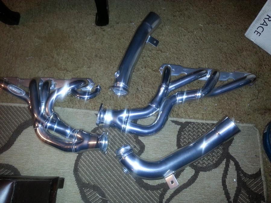

Wow those are awesome numbers for an L31!!
Who makes the headers?
Old Nov 6, 2013 | 06:15 AM
Fast355's Avatar
Joined: Oct 2006
Posts: 642
Likes: 21
From: Euless, TX
Doug Thorley made those but they are currently not being made. I tracked down this set on Amazon.
It runs well but I am in search of more. The original engine had 906 heads on it, the crate motor has 062s. It has never run as well as the original engine. I recently stumbled across an independent flow test of the Hecho en Mexico 062 head and they barely touch 220 cfm on the intake flow. A full 20 cfm lower than the 906s flowed before they were ported.
I am considering adding a set of 1.7:1 rockers to offset my .458" lift cam and swapping to ETec170 heads and going for 370+ rwhp NA.
