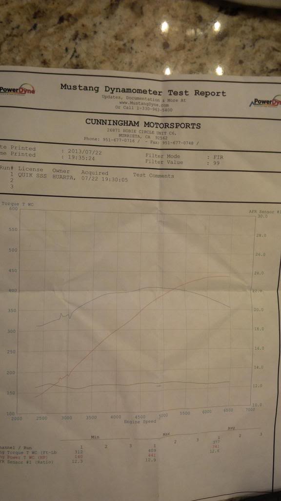

Well got my truck dyno tuned a couple weeks ago by Ryne @ CMS Motorsports. Truck made 441 rwhp/409 rwtq on a Mustang Dyno. Figured i would post my results. Truck has stock LQ9 with. 030" over Mahle pistons, PRC 799 heads, 11.4 comp, FTI 228/232 cam, TBSS manifold, LS3 TB, 8.1 injectors, built 65e, Circle D 3600 converter, 4.10's.

Dam nice numbers. Bet its pretty fun on the street.

Nice numbers. Healthy motor
