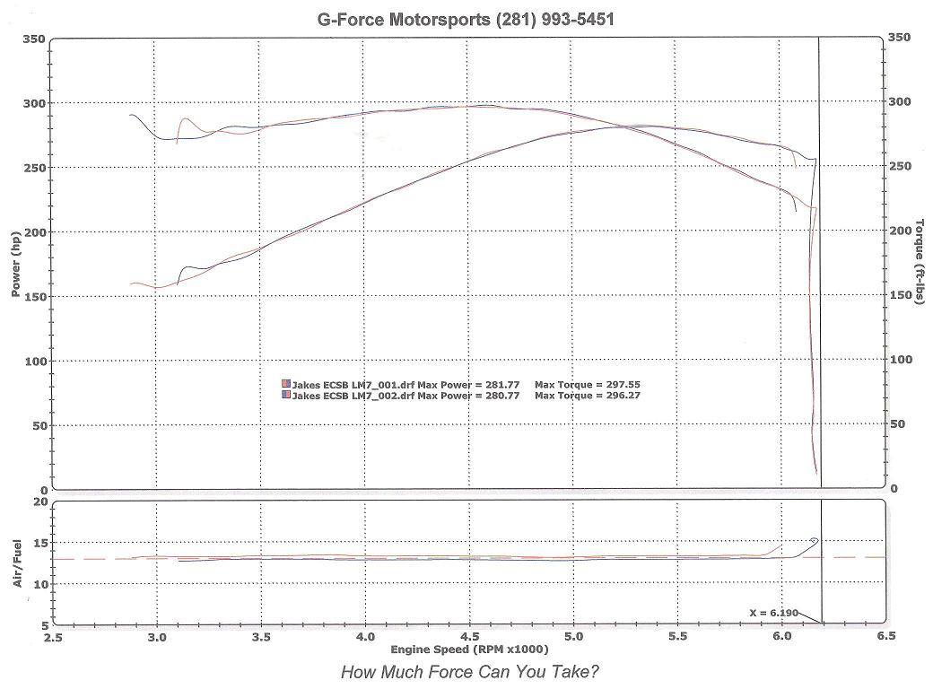

Well, I've been to the track plenty of times but now I'm getting it dynotuned this coming wednesday over at G-Force. I've setup a deal with Mike where he's gonna show me a little how to tune using the w/b setup. I'm running a mid-high 14 consistently so I really have no idea what power I'm putting down. Mike's convinced me to go nitrous, so we'll see where that goes
Based one what I've seen I shouldn't put more than 280 to the ground?
Anyways, here's the mod list, yall guess what it'll put down;
5.3 LM7, K&N FIPK, LT's, ORY w/cats, 160 stat, HPT.

Well, I'm quite pleased actually. 282rwhp and 298rwtq
Basically my mission today was to see how well the tune I've been doing with HPTuners was working. It was kinda nice to know that for not ever hooking up a wideband my a/f was peg on. Mike was kinda surprised that I had it down that good. My timing was perfect, so was my a/f. Couldn't have asked for a better day. Mike was happy too b/c he didn't even have to do anything haha. Anyways, here's the scan from this mornin. Next mod is the underdrive pulley and nitrous.
