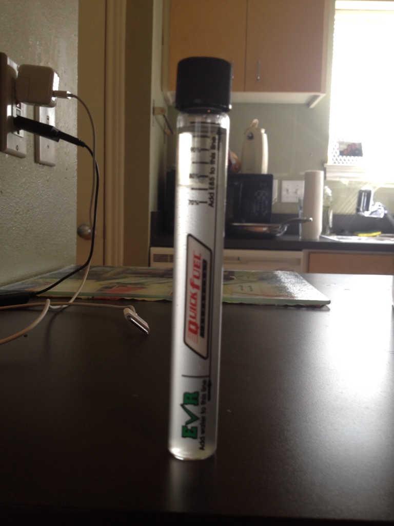

My attempt to mix to E60 failed. I thought the tank was more run down than it was. I got in 14 gals of E85 and 4.8 gals of 93. By the math that comes out to E71 assuming the tank holds a full 26 gallons.
I actually measured the fuel from the test port and it's coming in just a hair over E75 which makes sense because I tested the straight E85 which was coming in around 90% ethanol! Potent stuff, and would explain why my truck takes around 2 seconds to fire off with the straight e85. With this blend it fires up instantly like E10.
