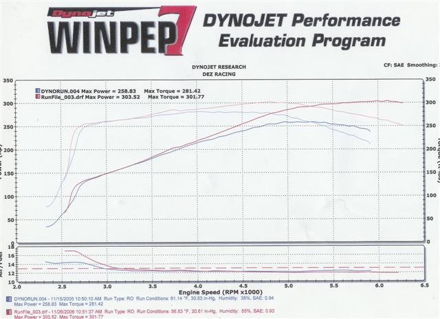

Before is stock with tune and Corsa exhaust. After is with a 216/222 Cam ,air filter,corsa and tuned. Still had stock converter,3.42 gears,and stock exhaust manifolds with cats.
Attached Thumbnails All 5.3l with cam/bolt ons come in-avalanche-dyno.jpg

Not bad, great gain from a cam alone. Whose cam is it?
