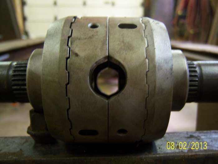

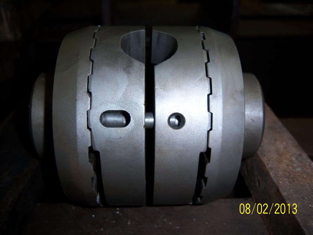

Here are some pics of my Powertrax Lockrite mockup I made a few days ago. I went through 3 of them, this is the 3rd unit I didnt feel like shipping over the border for warranty.
Mock up on my alignment rack

Locked position
Unlocked
With a shearpin installed, there are 4 of them when installed in truck.
Coupler and driver assemblies
Compare the above Powertrax Lock Rite Locker, to this Powertrax No Slip Traction System. There are extra parts which are supposed to help quiet down the ratcheting sound while cornering.
