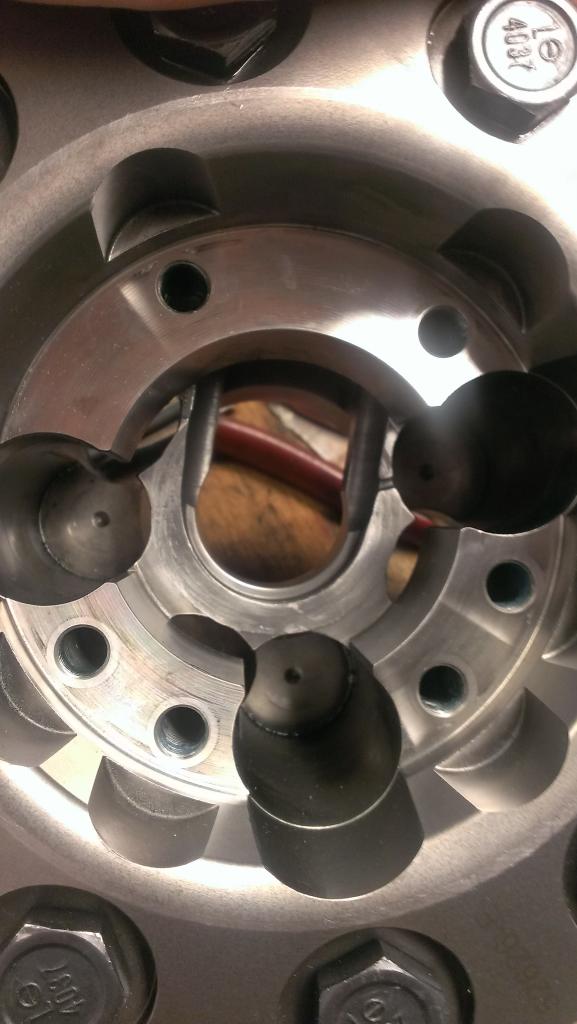

This is what the inside of my case looked like from the gear rubbing. Notice the first pic has 3 oil valleys and the other side only has 1...go figure ??

Waiting on new carrier shims now and I will slap it back together. In case anyone else has a Tru-Trac diff, be sure to change out the axle C-clips
every year or so to help keep this from becoming an issue. Seems to me this could have been designed with a Trunnion Bearing to keep the gear from ever touching the case. My last LS2 timing chain sprocket was designed like that. I think it was a Jennings.

Both sides of my unit had 3 oil grooves. I doubt they changed the design. Check to see if they are full of debris.
