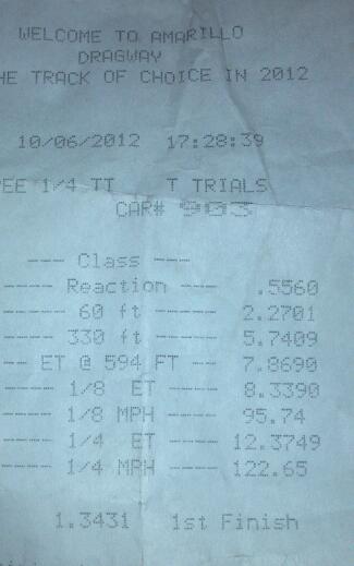

Here's another example, my truck...
My 1/8 mile don't match my 1/4 mile even close! According to the Wallace 1/8-1/4 calculator, I should have ran a 13.05@118.67 but I actually hit full boost in first and second.

Your 60' is what is killing you. If you knocked off some 60' time, it would be much closer.
