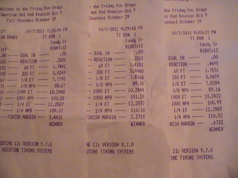

New best last nite... had my cam reground to 238/248 dur and 595/612 lift. New dual springs. Took some more weight out, was 4680 with my fat butt now is 4320. plan on FG hood eliminating sway bars and doing something with the bumper. Need to get down around 3900 with me in it. That means I need to get serious about weight loss. First run was in left lane and it got real squirly about the 60 and I let off alittle got right back into it and got squirly again. Was checking things out and foun my emergency brake was down about 1/4 the way talk about feeling dumb. Corrected that ran right lane and turned a 12.25 WOW what a difference. Goal is 11.80's on just motor (engine) When I get as close to that as I can then its Nitrous time.

Congrats on the new PB! Just getting that 60' down a little should damn near put in the 11's.

nice runs Steve-O !! get the 60 down and its a done deal

Nice!! Don't see many carb setups. very nice mph...
