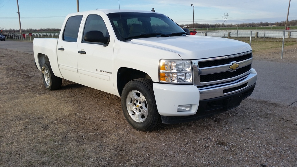

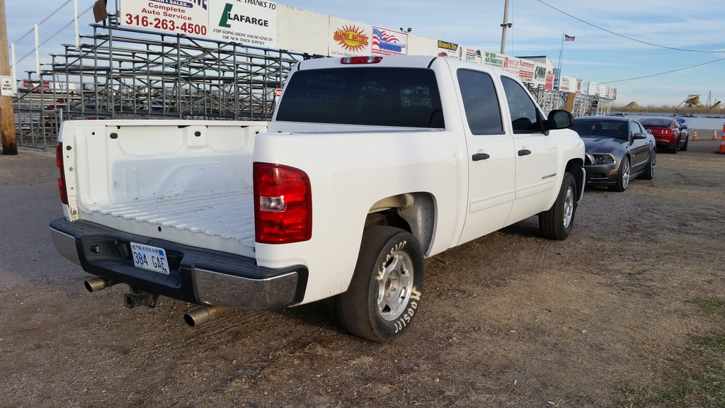

Default '09 ccsb 5.3 13.9@98
Ran my 2009 Silverado CCSB 2wd last Saturday @ KID in Wichita. DA was about 2000ft and about 10 mph headwind on my best pass.
Specs:
-Iron block 5.3 w/6L80e
-3.42 w/G80 rear
-JFR spec'd Isky baby cam (210/216 .532 lift 108 LSA)
-FTI 2600-2800 triple disc
-Pacesetter 1 3/4" LT's
-3" ORY w/cutout after
-Stock intake w/K&N
-Stock suspension
-5300# race weight
Best pass was a 13.9@98.7 with 2.02 60ft

What all is out of the truck for that weight? And what tire is that on the rear?

Just spare and tailgate. Tires are 28x10x16 Hoosier Slick
