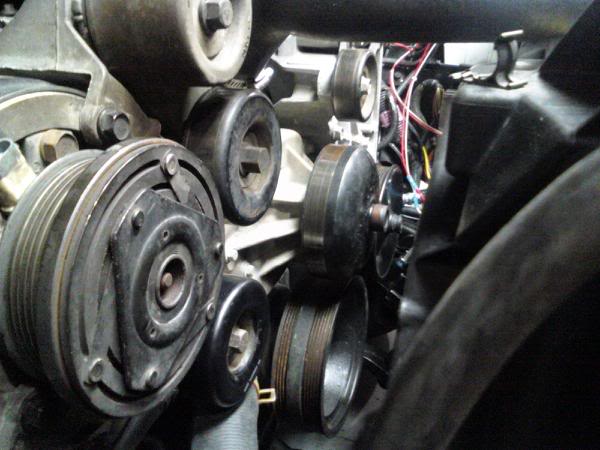

Dad drove it for the first time.... I didn't ride along, my mom did, and said he went to fast and took off like a teenager....so that must have meant he laid some rubber and hauled azz!
I also had a chance to mess with the AC. Took a bit, but it should work. Going to get a belt today and fit it up to see how its going to work.
