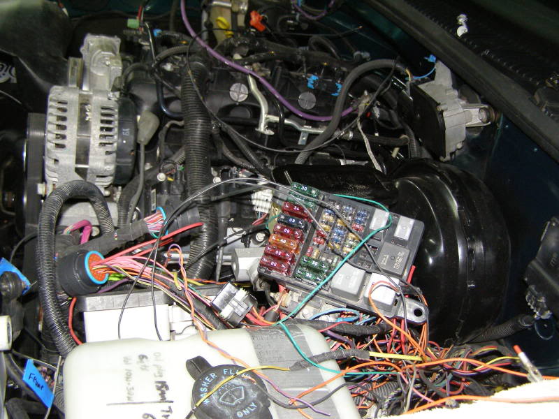

Dad came up and we worked on the 95 some today. I did some work trouble shooting the issue with the ign wire that read 10v with the key on, and turns out it has a short to ground somewhere between the firewall and colomn, and it was not the ign switch. I bypassed the ign wire and all worked as expected.
Dad spent time making a template for a cold air box, we picked up a 9" K&N filter, tomorrow we should have it cut out and welded up.

wow thats a wiring nightmare simply bc im dumb when it comes to wiring lol

man all that wiring scares the hell out of me. i'm glad you got it running, now throw a tune in there and tell us how your dad likes the power over the ole 350
