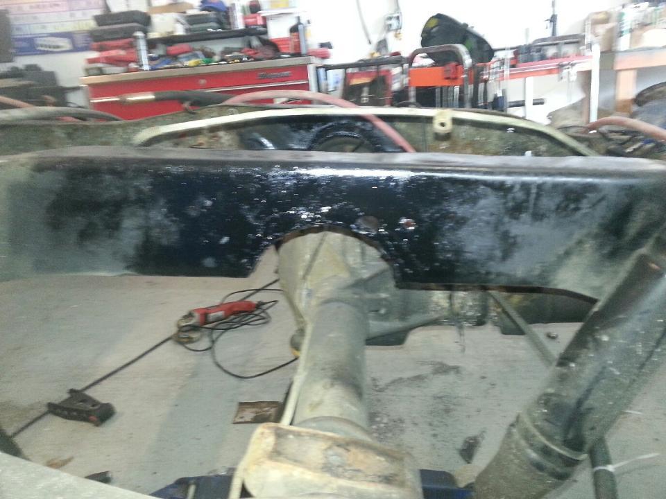

Anyone got an idea how much I would need to notch the frame for a 6" drop (2wd obs)?
There's also not much room between the frame rails and the bed, I hope I do not have to cut the bed....

Here is my buddys c10 right around the same year as your truck.
Old Nov 27, 2013 | 12:46 PM
JurgenS's Avatar
Joined: Aug 2013
Posts: 73
From: Belgium
Great! I was really thinking I had to cut the whole frame and make a notch that came through the bedfloor.
Now only need to find the stock shackles & hangers back

I flipped the rear axle and have a 1" block. so I guess probably 7-8" drop? I used the belltech bolt in c-notch kit and it has plenty of clearance with the oversized bump stops they send lol. they make it straight forward with a cutout to follow and where the bolts go.but definitely don't need to cut out the bed.
Part #: 6611

This is how it is currently done;
I will need to update my project in the classic truck board...
