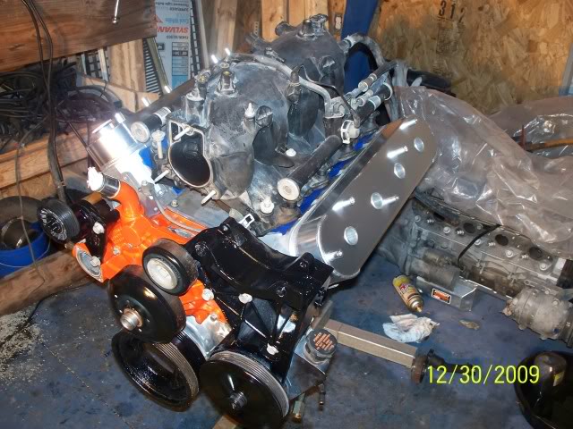

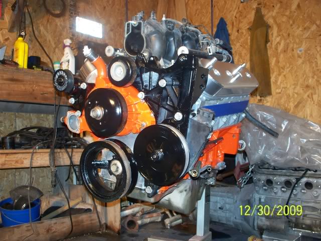

Well , here I go again I have already installed an LS moter in a '79 C10 and started to put an LS motor in a '65 Chavelle. This time I am putting a 5.3 out of a '03 GMC Seirra into my daily driver '85 short bed Chevy C10. Here are some details on the motor....
I started off with a complete 5.3 pull out, disassembled it, left the bottom end alone, freshened it up with a new timing chain and an oil pump. I put a low mile Z06 Cam in it, and a set of ported (by Chris Mitchell) milled, and cut for bigger valve 5.3 heads.

The truck is my daily driver so I am hoping to get it back on the road ASAP!
I am hoping to pull the old 350 this week end so I can get started with the install. Thanks for looking.

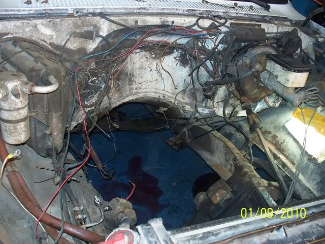

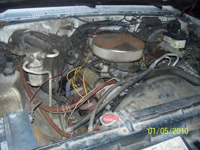

been busy today. i started unhooking things last night.
this morning i pulled the 350/350th out.

im going to clean up the engine bay tonight. heres the empty hole...
i seperated the old combo and reinstalled the 350turbo on to the 5.3 today also. im going to try to have the motor sitting in its new home by the end of tomorrow!

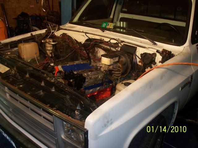

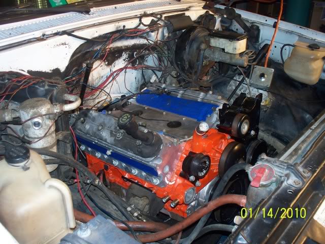

all right, i finally got the motor/trans shoved into the truck tonight. for mounting i am using ls to smallblock adaptors with the original clamshell truck mounts. i am reusing the th350 mount. i moved the motor mounts up a 1/4" to compensate for the adaptor plates. looks like im gonna have to move the crossmember forward an inch. i checked the driveshaft and still have plenty of engagement. here are some pics....
