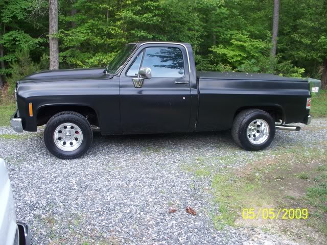

yes im wiring the truck wiring into the 5.3 fusebox. there shouldnt be a whole lot of wires to run. ive been gathering parts for this swap for quite a while. plus ive done this kind of swap before to my 79c10. but that truck was way more complicated! heres a coulpe of pics of it....

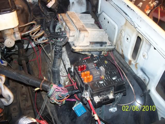

alright, more pics.......
here, i mounted the pcm& fuseblock

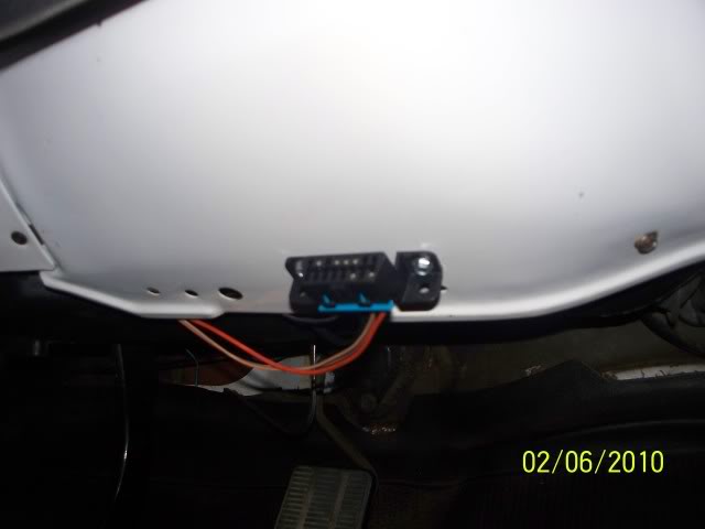

i ended up mounting the data link under the cd player.

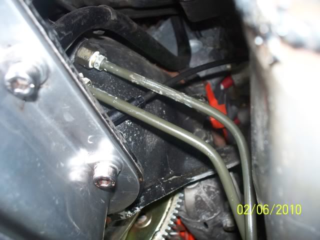

here, for trans cooler lines i used lines from napa that dont require a tubing bender! too easy.

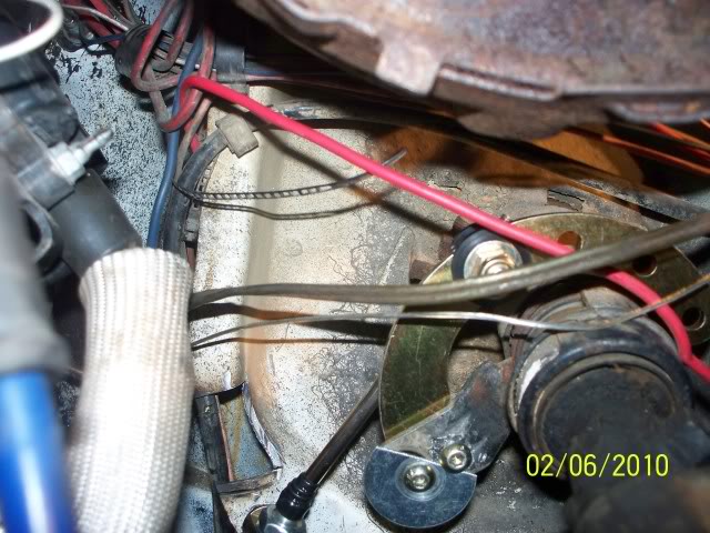

i am using a shifter linkage coversion kit from lokar because the stock shifter linkage hits the top of my header.

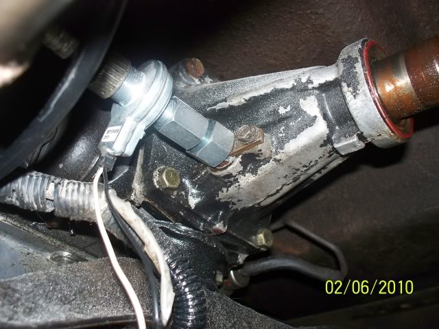

this is for guys keeping the old th350&400. its give the vss a signal. without it your pcm would never get out of its idle tables. this sensor tells the pcm the truck is moving! it also allows me to retain the stock speedometer cable.
