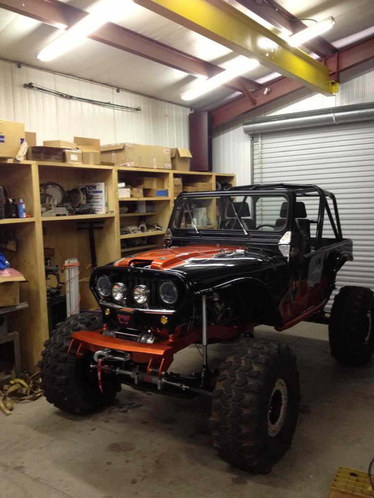

I had a red/yellow CJ3b with a 406 in it years ago. But you are probably thinking about another CJ with 8.1L from Alabama. I have seen photos and videos of it.
This is the current project

Old Apr 30, 2013 | 12:20 PM
xx_ED_xx's Avatar
Joined: Jun 2007
Posts: 2,229
ha ha thats kick ***, so 2 jeeps with 8.1's freaking amazing
Old Apr 30, 2013 | 01:07 PM
02_2500avalanche's Avatar
Joined: Jan 2005
Posts: 313
From: Woburn, Mass.
whats the lobe separation on that cam? jeep is badass
