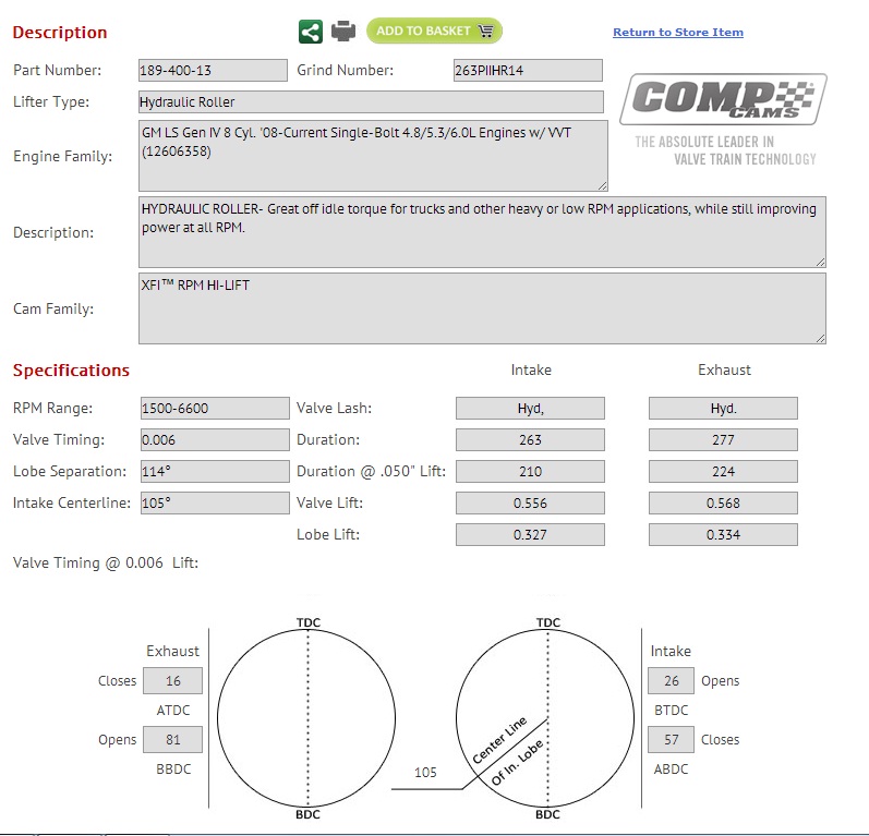

Spoke to Comp Cams tech, they recommend this cam for the LC8 (assuming thats the engine thats in this unit!)
I have no idea how to read numbers though. I'm thrown off by the massive RPM range. I have a theory in life, anything that does everything is not as good as something that does one thing only. (i.e.: an adjustable wrench doesn't work as well as a combination wrench, and a grill for your kitchen that has 18 attachments doesn't work as well as a bbq)
What do you guys think of this for a towing cam? Truck seems to cruise around 2000 rpm when towing, and doesn't seem to go above 4500 RPM unless your an animal on the throttle. Also I will be installing long tubes on it, my pipe dream is ARH, but I may resort to hooker headers or something of the like. Long tubes for sure though.

That cam would work. Its in the ball park of what I just recommended. That cam is a VVT cam which could help with bottom end power too.
What I had in mind was not.
Old Aug 18, 2014 | 02:58 PM
anheuserbusch08's Avatar
Joined: Dec 2008
Posts: 397
Yep. It's not safe to go too aggressive on vvt cammed engines. One exception I know is that there's a 2013 camaro ss l99/6l80 that's running an ehi lobed vvt cam that traps 7.0 in the 8th mile all motor lol
