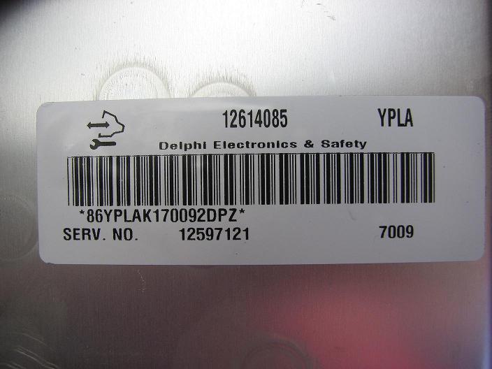

It looks like both E67 and E38 ECU's are utilized in the '07 models. I have a '07 Sierra (5.3L, 4L60E, AFM, E85) and it has the E38. The service number on the label is the same as the Escalade/Denali units but some of the other numbers are different. I can post some pictures up tonight when I get home.
According to the schematics the networks are GMLAN High Speed and GMLAN Low Speed.

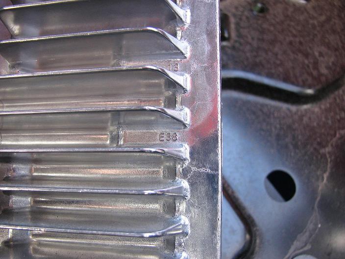

Here is a picture of a E38 computer I got off the EFILive forum.
Post some pics up when you get them.
BTW, what '07 trucks have you found that have the E67 in them? When I searched on that link above it didn't list any trucks, it could be outdated or something though.

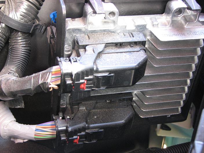

Pic of E38 from 07 Sierra 5.3L
How do I paste pictures?????? I don't want to attach them; simply paste them in text.
