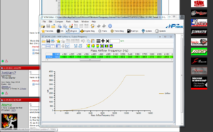

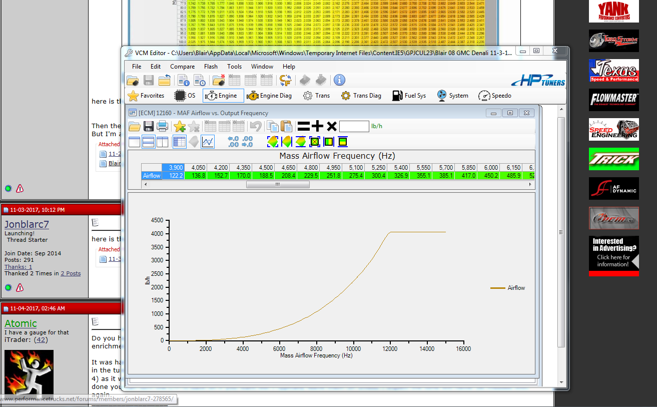

Why does my MAF table look like this. All other example I find of a MAF table don't level off at the top.
Old Nov 6, 2017 | 09:12 AM
Atomic's Avatar
I have a gauge for that
Posts: 16,282
Likes: 438
If its not at the MAF limit it has a constant value in there. Looks like the whole thing was scaled 20% or something though so the top third of the curve is truncated at the MAF limit.
