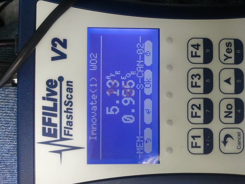

What does the AFR read on the FlashScan? I don't have mine in front of me but I think it is: F1>F2>F1>F4

This what you mean?

Yeah, that's what I meant. Man that stinks if the unit is bad.
