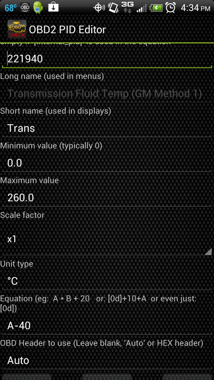

I have confirmed that the trans temp is accurate with my Flashscan. Here is what worked for me on my 99 Silverado.
Go to:
Menu
Settings
Manage Extra PID's/Sensors
Transmission Fluid Temperature (GM Method 1)
Select edit, and make sure all values and names match this.
The go to:
Real time data
Add display
Transmission Fluid Temperature (GM Method 1) should now be highlighted in green
Select it

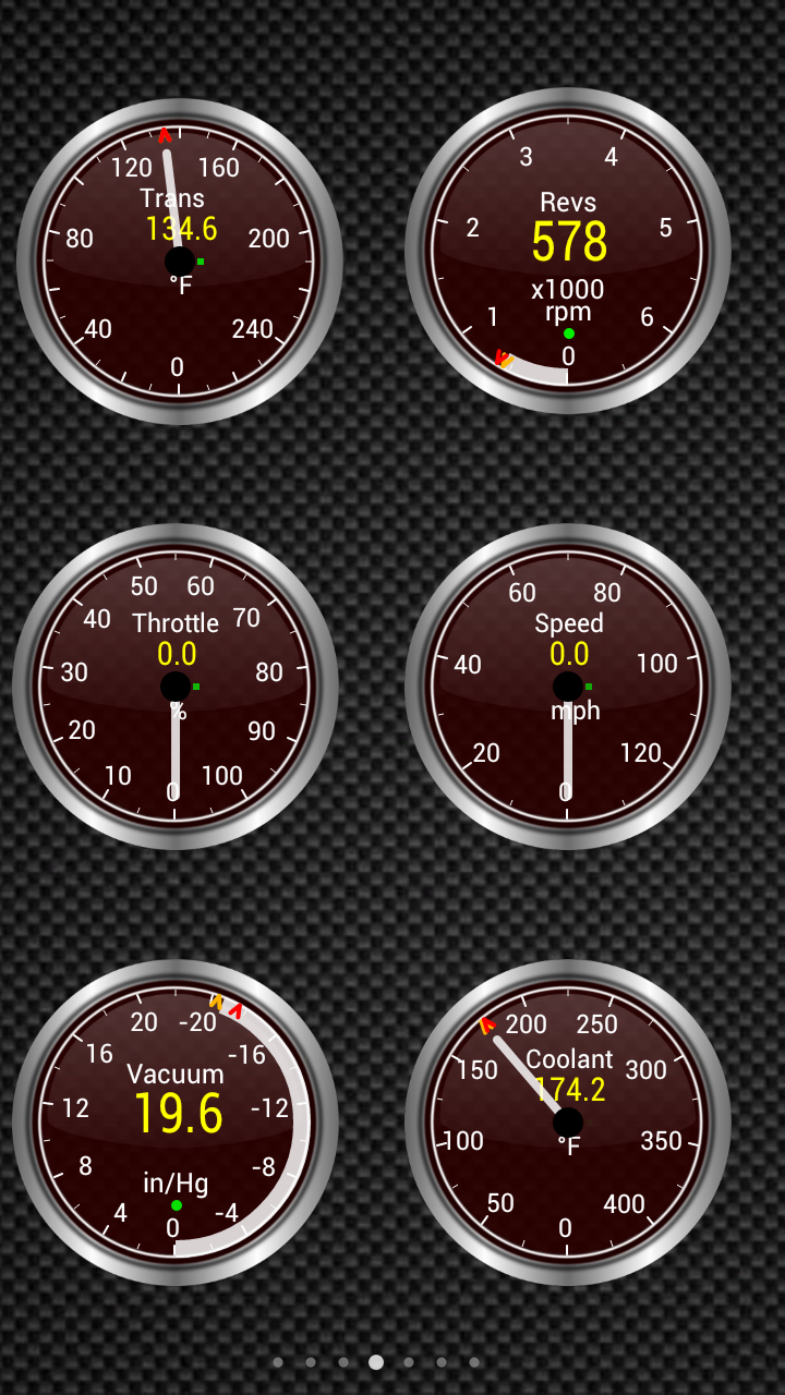

Here is a screenshot of what mine is like working.

It now works great! I am very excited. I can't wait to throw a trailer behind the truck tomorrow and make sure it doesn't get hot!
