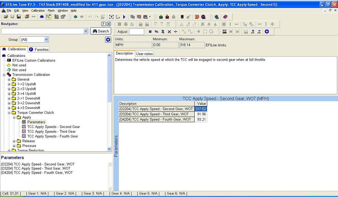

Latest efi update:
{D2204} TCC Apply Speed - Second Gear, WOT
{D3204} TCC Apply Speed - Third Gear, WOT
{D4204} TCC Apply Speed - Fourth Gear, WOT

Originally Posted by shupe
I believe the thread below on the EFILive forum is discussing the converter locking @ WOT issue.
Converter Locking @ WOT, why - Page 2
I'm updating efilive to see if the parameters are available on my t42 os yet.
Interesting thread. Let us know if there's a updated OS with that patch.
I'm kinda curious if I can use the DVT controls in the scanner to over ride the TCC lockup and see if it still Trys to lock
