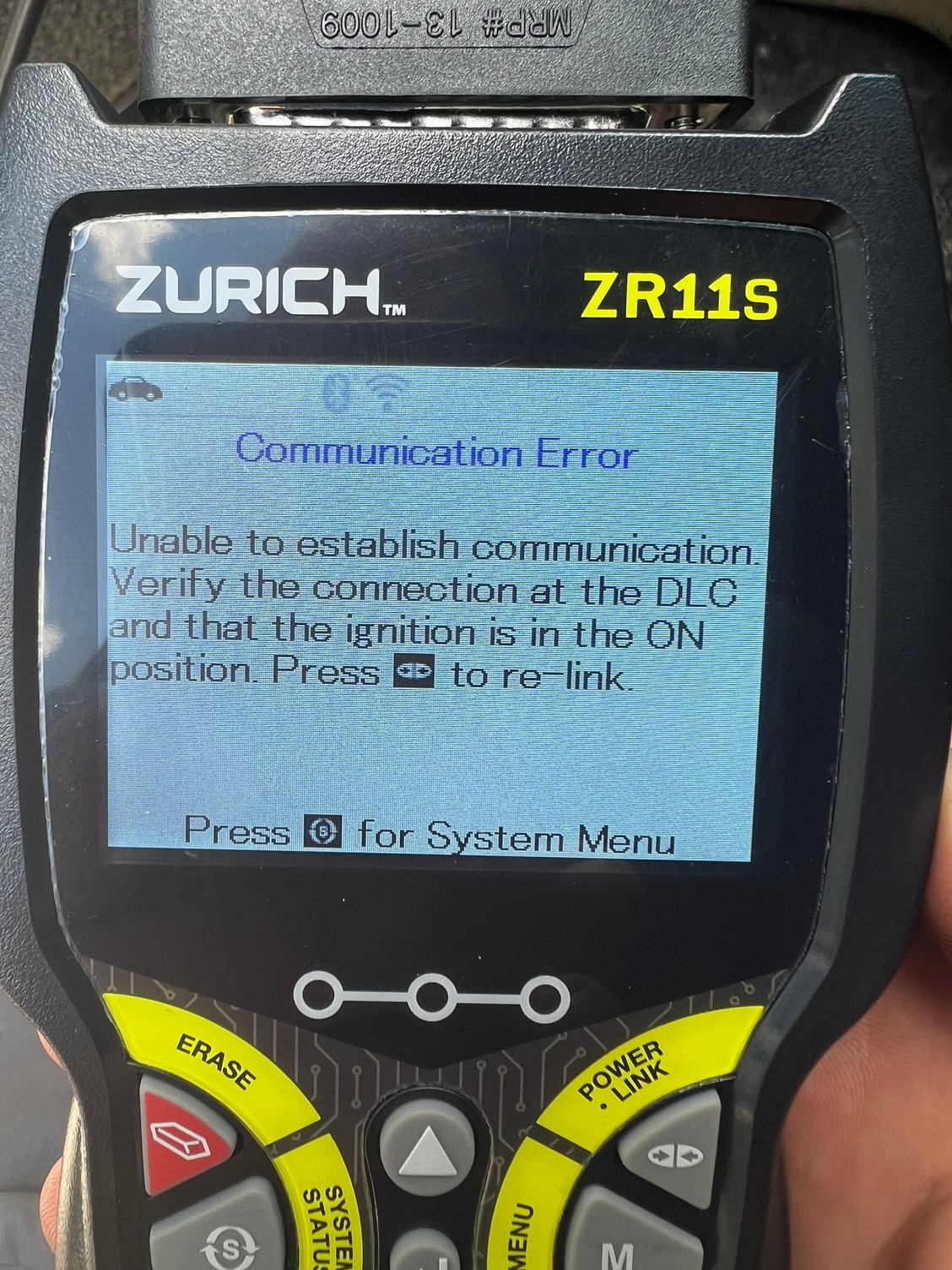

4. Scanned the SRS for codes…no communication. All other scanner functions work on this vehicle and all functions work on my jeep and ram.

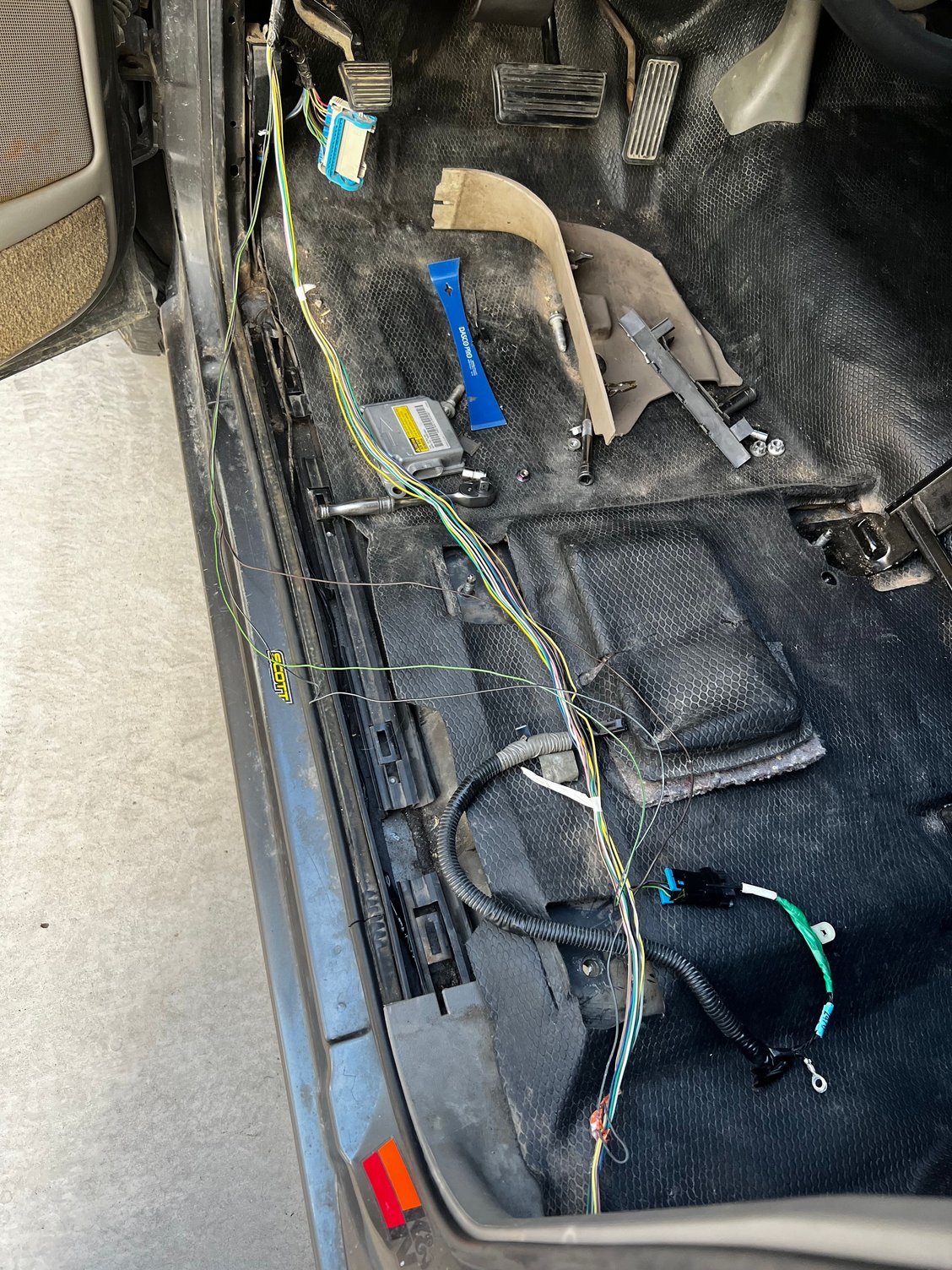

5. chased all wires for shorts and breaks, ohm tested all fuses and the clock spring. No issues.
6. Swapped in a Tahoe crash module to see if the restored one was not functioning… still no communication.

As for your communication issue, Have you tried it on a similar vehicle? Does the scanner communicate with the engine side?

I replaced the clock spring, passenger override switch and the crash module. Still no communication. The only change is with the airbag light. With the old module, constant flash. With the new(used), it’s always on.
The scanner can perform all functions on the Silverado except the SRS. I don’t know anyone with a similar vehicle, but like I said, everything works on my other two vehicles. 🤷

You still need to rule it out on a similar vehicle by checking it's function. I sold my 2000 a few years back but I know the communication on some of the stuff was different between the 99-02 and the 03-07 classic. There were even minor differences in the 99-00 to the 01-02 trucks software. This is also why I asked if it communicated with the engine side.

With out the codes, It's just a guess as to what's wrong. I don't know how bad the accident was. If there was any pinched wires or anything that was removed, I would go back over all the connections. Check for bent pins or loose connections. Including the belt buckle. They have sensor to see if the belt is plugged in or not. some times those have to be replaced as well.
