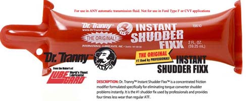

If it is toquue converter clutch chatter you might try a product called Dr Tranny Instant Shudder Fix. I've used it on a vehicle that can TCC shudder and it seemed to fix it. It was a 97 Merc Cougar. The shudder hasn't come back for about 4 years and the fix was pretty instant. The only thing is TCC shudder doesn't usually occur when slowing down but under light acceleration when locked up.
