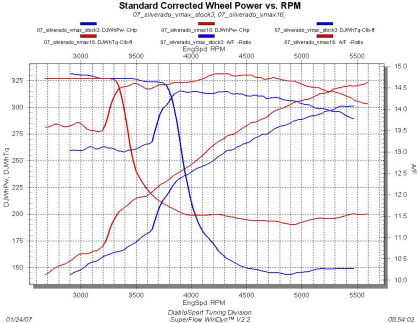

I asked diablo about tuning for nexgen and they have a programmer[part# u6194] and emailed a chart which happens to be this.........
https://www.performancetrucks.net/fo...chmentid=40864
Nice chart, big mid range improvement and big afr change
