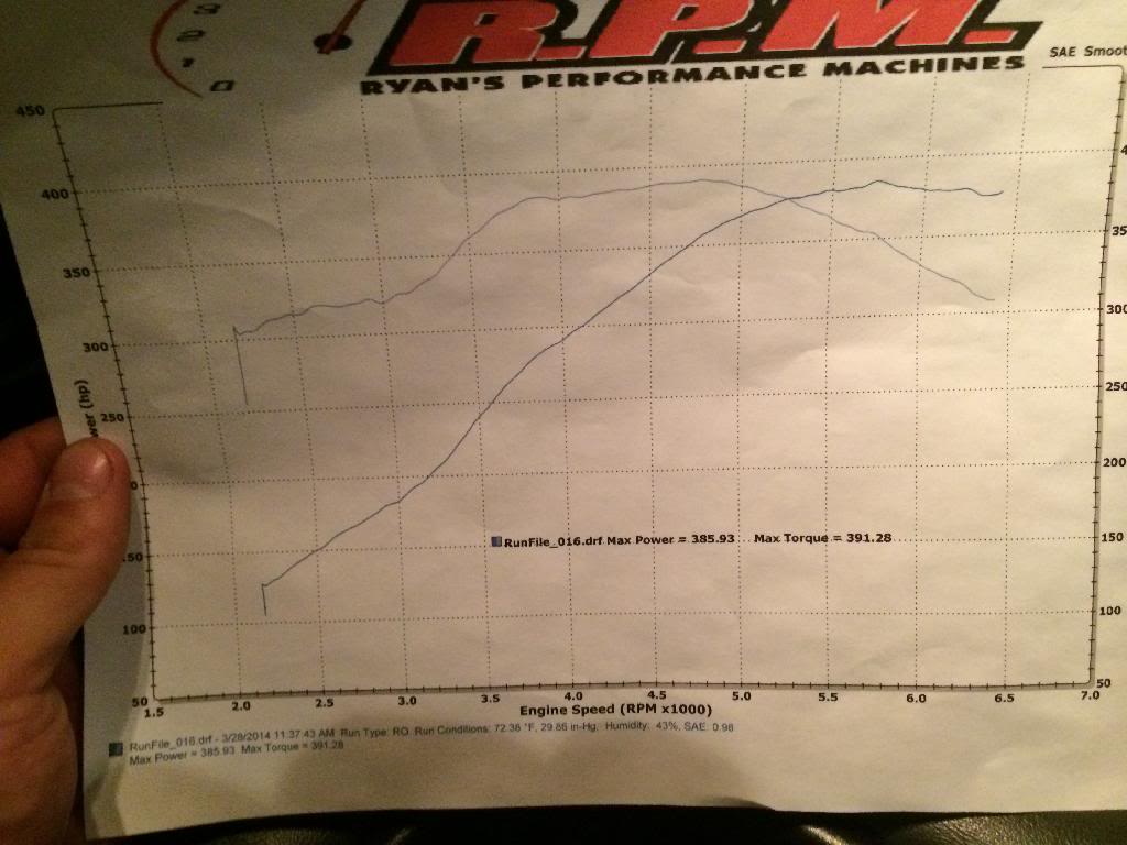

minor adjustments, shift points, what would you change?

2006 silverado ss id like if someone could take a look at my tune and setup and give me their input if there's anything they would change. I feel like i need to adjust shift points. stock-ish lq9 with arp rod bolts and head studs, 227 236 .613 .578 113+3, comp pr's, tooley spring kit, built 60e, yank ss3600, tbss intake, flex injectors. also have a nitrous tune, but id like to get this one as best as i can first. do you guys think i should raise my shiftpoints from 6000 rpm to higher?
