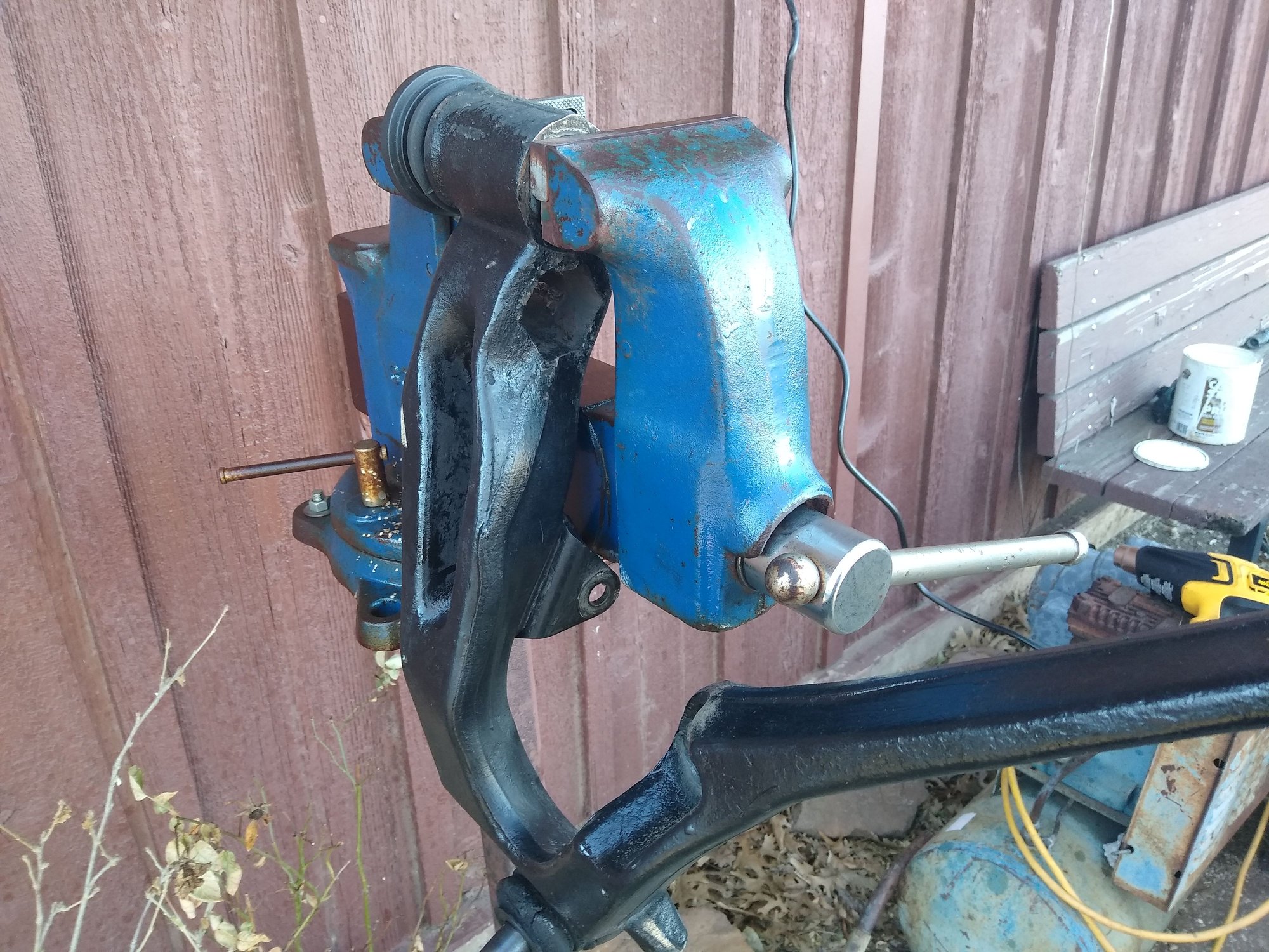

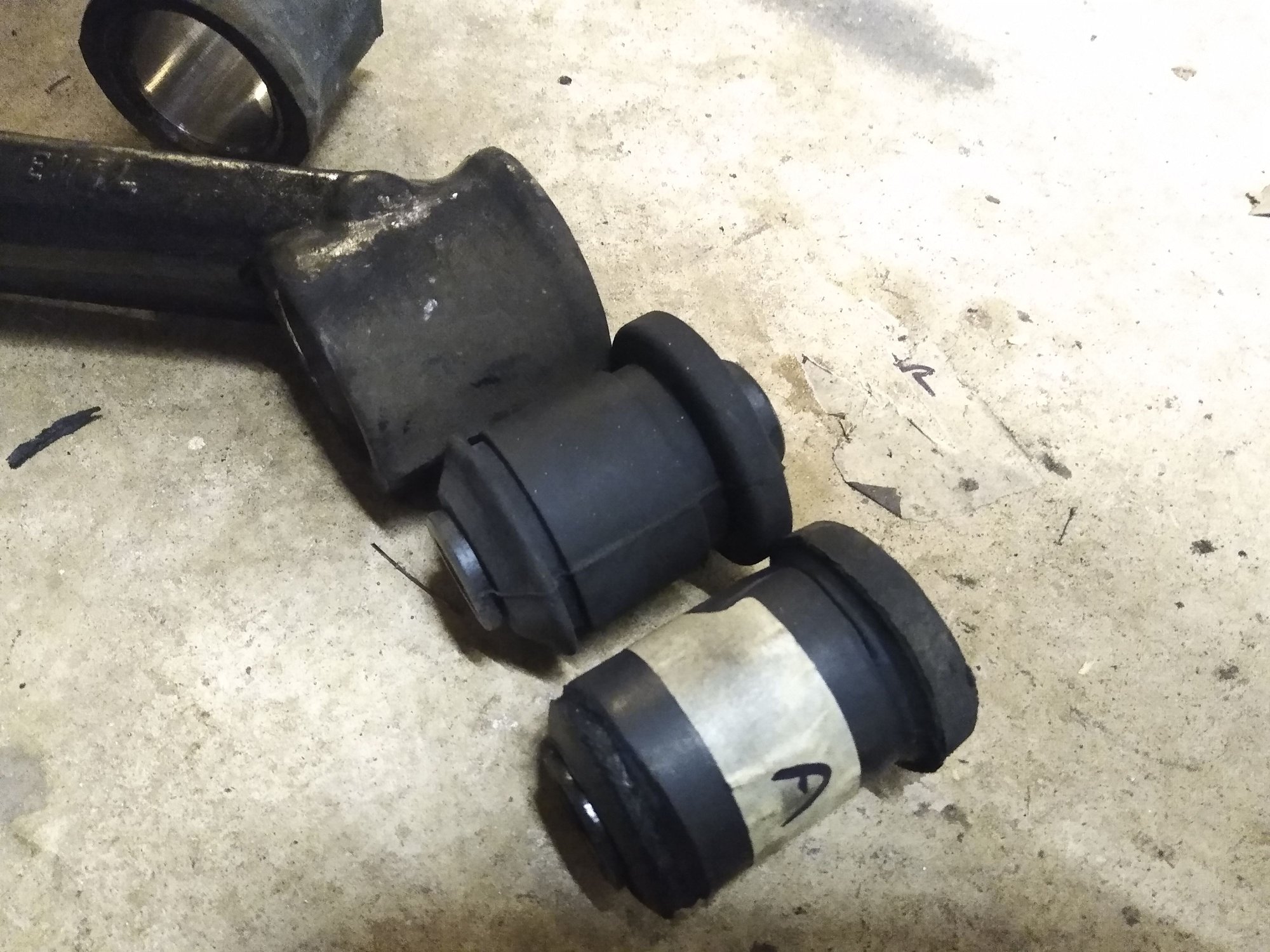

I have installed the UCA bushings and ball joint. That was pretty easy. LCA OTOH, have been a challenge. I saw on-line how to use the balljoint press in a different position to remove the bushings. I found my race installer had the perfect size diameters to push them out on the hole. I struggled to install them though. At one point I thought I had gotten the wrong parts because the new AC Delco ones "seemed" different than the ones I removed. Went to O'reilley and their store brand bushings were exactly like the Delcos, so went back and pressed them in. I bought some sillicone lubricant and that seemed to help. The old ones actually looked pretty good. I'm wondering if the PO had them replaced? Oh well.
Last item are the LCA ball joints. I pressed the old ones and trying to press the new the BJ wanted to go cockeyed. Trying to hold that heavy arm on the press with the 2 arms horizontal while keeping it at the right angle on the BJ is proving challenging. Tonight I'll get my oldest 11-year-old son to help me holding it.

Alright, got the LCA ball joints pressed in. Started them with BJ tool and finished them in the shop press. Got everything back together. I think I got the hang of it.

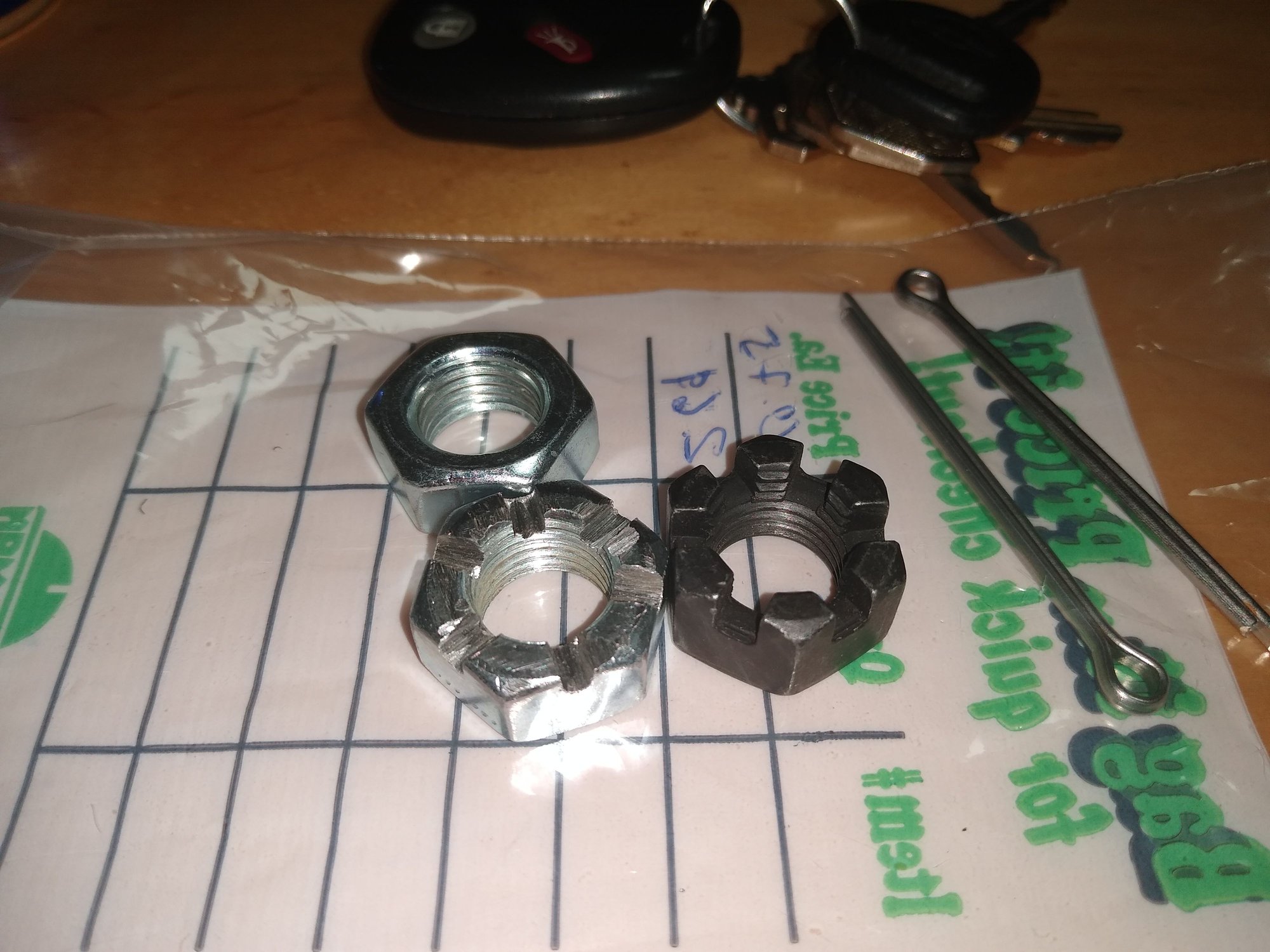

Tonight it got worse: driving home the truck started vibrating violently. I was able to slow down and pull over. After a quick peek I saw the outer tie rod had separated completely from the knuckle! 🤬 I was able to limp home. I know I had installed the cotter pins when I installed the tie rods. I'm going to complain when I take it back to Pep Boys.
Now I need to find a replacement castle nut. I stopped by O'Reilly's and they said they don't sell just the nut, only the complete tie rods.🤦‍♂️

Just go to the hardware store.

Also yeah that was an L. Always do new bushings.

Ok, thanks. Yeah, I was thinking going to the local Elliot's Hardware to look for a castle nut. I thought I still had the old tie rods to steal the nut, but I tossed them. I'll take the passenger tie rod nut to see if I can find a match. 🤞

Worst comes to worst get a large nut and cut slots in it

Fu#$@&CK X2! I went to the other tie rod to take the nut off to try to find a match for it and it was about to fall off as well. Maybe 2 threads engaged! 🤬 So much for the $110 professional alignment service!
Just ordered a real castle nut on line, as all I could find was a regular nut (castle nuts are taller) and cut a few slots for the cotter pin. It will do for now...😒
