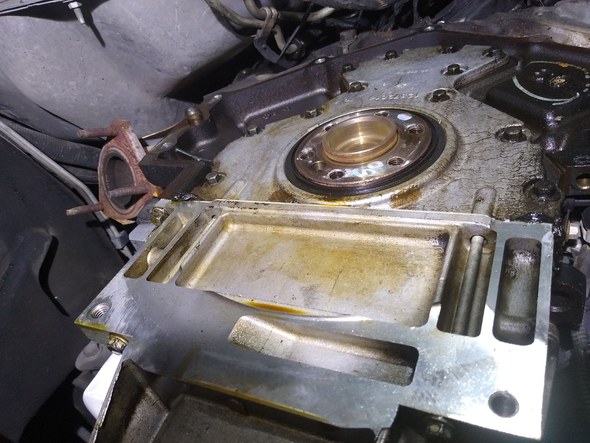

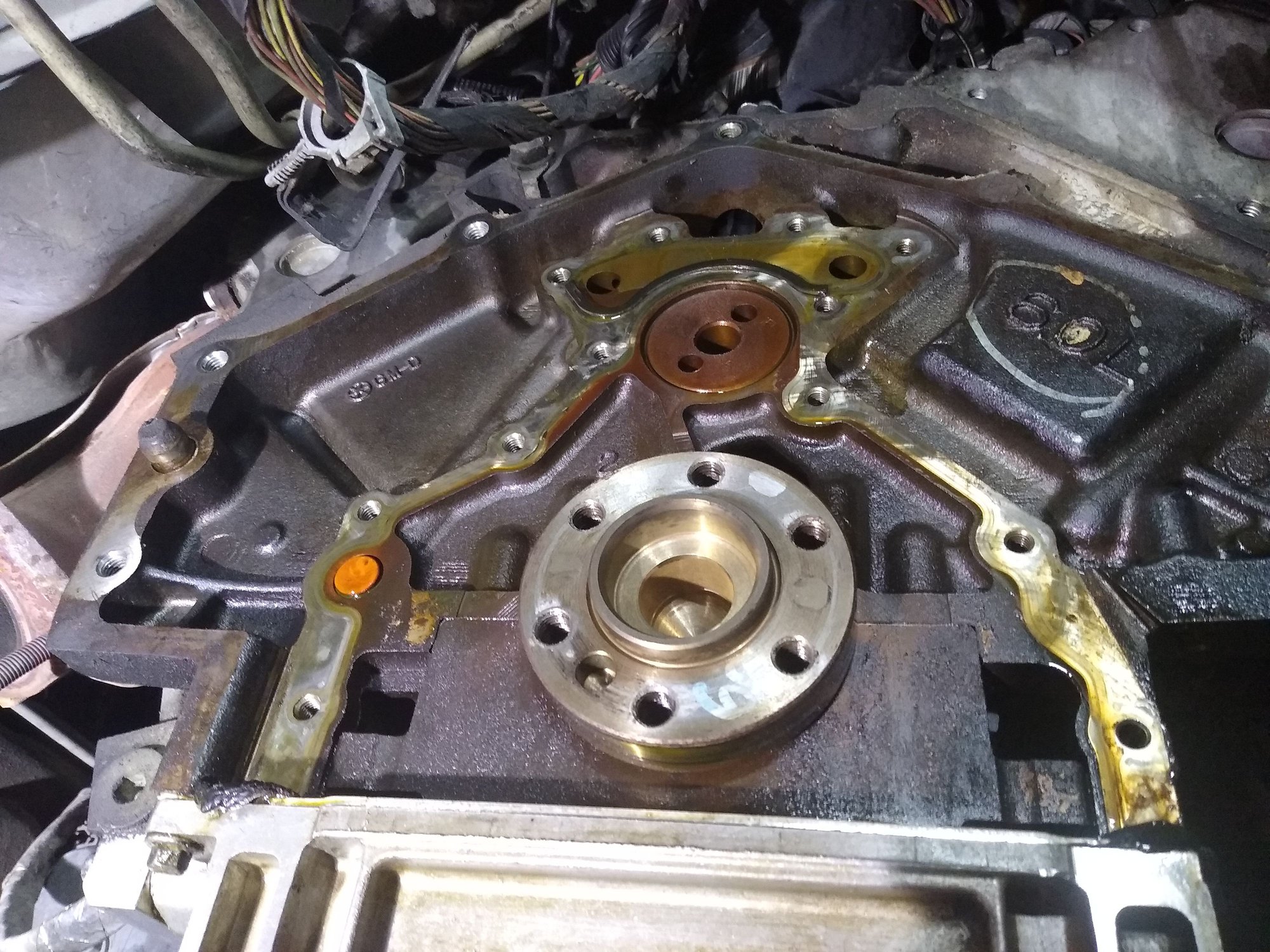

Ok, I finally was able to drop the transmission. Seal is indeed leaking. Inside of transmission bell housing also has oil flung onto it.
Here's my question now: do I install the crank seal on the cover, then install the cover? Or do I install the cover w/o the seal and instead with the centering tool, then install the seal on the crankshaft flange?
None of the YT videos I've seen on doing this job use the centering tool. 🤔🤷
There's your problem lady! 😊
I also bought that little barbell restrictor do-dad since I'm here.
Old Nov 29, 2022 | 07:53 AM
  #25
shakenfake's Avatar
Shlumpt
5 Year Member
Joined: Nov 2019
Posts: 4,460
Likes: 1,529
From: Shlumpt, TX
Last time I pulled the cover off and did it on the bench without a seal centering tool.
Old Nov 29, 2022 | 09:40 AM
  #26
Jeff71's Avatar
5 Year Member
Joined: Jun 2018
Posts: 120
Likes: 44
If you want to use the tool you bought, install the cover with no seal then install the seal. You can do it the other way as well but then there would have been no reason to buy the tool. Video available on Saccitycorvette's site where they sell the tools.
Old Dec 7, 2022 | 09:12 AM
  #27
strutaeng's Avatar
5 Year Member
Joined: Oct 2020
Posts: 1,177
Likes: 329
From: DFW
Well, good news.
I was able to install the new rear main seal. I went to the SacCity website and watched the video. Pretty much installed it per their instructions, except I initially forgot to add the cover gasket. Doh! Had to do it twice.
I had decided to remove the torque converter on the transmission and clean the inside of the bell housing. I went to the local Whatever It Takes (first time going there) and bought a torque converter lock-up o-ring and front pump seal. Normally I wouldn't do this kind of thing
not sure why I decided to do it. Anyways, they must have me the wrong pump seal! It didn't fit. So I went to O'Reilly's and the second store had it. Had to give them the part number because it said that part "didn't fit my application."😬 It was National part number 714598. I removed the rear speed sensor to enlarge the hole on the bracket because I couldn't get the fuel lines to align with the little bracket again.
Monday night I got the thing back together and started it up. Didn't see any leaks. Took it for a spin and after the second or third shift it did a hard shift and the ABS & "Service brake" light came on. I also didn't have speedo. Did a U turn immediately and got back home. Checked and I had a P0502.
Last night I crawled under there and output speed sensor wires at the pigtail where missing insulation and touching each other. I put some electrical tape around them. Then the thing wouldn't start. It started and immediately die. Spent 2 hours checking stuff like fuses and fuel pressure. I put the battery charger overnight and this morning just got clicking. So I borrowed the battery from my 99 Silverado and she fired right up. Everything seems good 👍. The ABS light went away.
