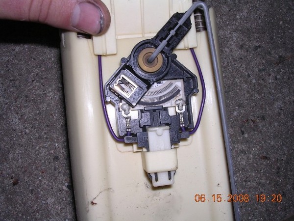

Yes, The sending Unit Is going Bad!!! Its integrated in with The Fuel Pump Assembly.
I have been told you can buy the sender unit sepratley, But since you have to pull the whole unit out Why not just replace the whole damn thing any way.
The other common thing Is the Plastic tube from the pump motor up to the top of the assembly springs a pin hole leak bleading off the pump pressure...
BTW, Pump out as much gas as you possibly can. Even on E there is still about 5 gallons or so in the tank to keep the pump submerged... Remeber Gas wieghs something like 7-8 pounds per Gallon. I forget the exact number but you get the Idea. I thought I was good when It was just getting to the E. BOY was I wrong.... I am not sure exactally how much was left in mine but It was some wear in the 80 -100 pound range and I did mine on the drive way with Jack stands and Floor Jack.
You can see in the picture I attached. There are little metal fingers on the float assembley. They either break off or get bent and no longer make proper contact with the switch. If I am not mistaken High resitance is full and low resistence is empty. So when there is no resistence from a defective Level it just goes to empty on the gauge...
Attached Thumbnails Low Fuel Light Comes On/off-fuel-pump-1.jpg   Low Fuel Light Comes On/off-fuel-pump-2.jpg   Low Fuel Light Comes On/off-fuel-pump-3.jpg
