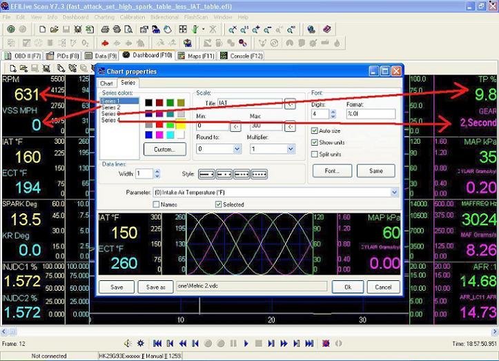

Right click on the graph summary area that you want to change and you can select whatever logged item to display.

right click in one of the 4 quadrants in the graph screen and then you select "graph properties". There you can select which "PID" or logged item you want to view for each of the sections of that quadrant. You can change the limits, fonts, size and other things there too. You have four selections for each quadrant and four quadrants in the screen for a total of 16 different PIDs you can monitor at once. I attached some screen shots.
