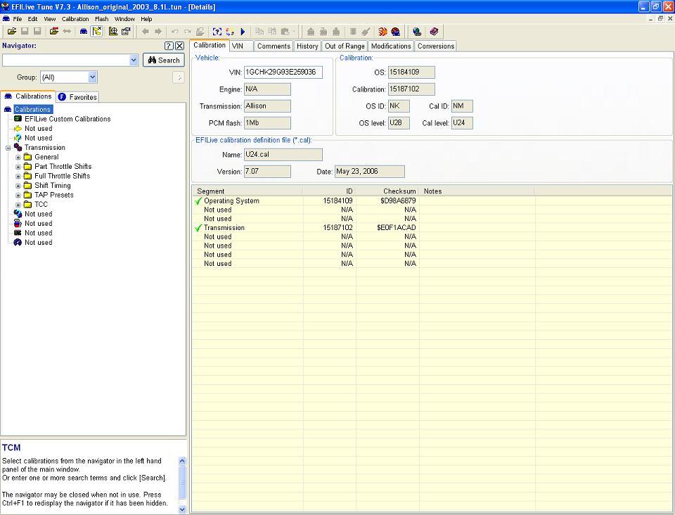

That stuff is in the PCM screen, all my tranny tuning is done in the Allison TCM. Its a totally different screen, with totally different selections than the tranny stuff in the PCM screen. I posted a screen shot of the Allison window. See how on the left all i have is the tranny selection.

Yes, just like you open a .tun file for the PCM.......there is a .tun file for the Allison. Its a whole new world for the tranny tuning with the allison. There are different PIDs and Allison scanning/logging too. Its sort of an anomoly with the 8.1L allison trucks, because the diesel trucks dont have a transmission section at all when you open up thier .tun PCM file. So i think that any changes made to the tranny section of the 8.1L PCM have no effect. At least thats what i am told. I really need to ask someone who knows for sure, but i cant find anyone...LOL. If you open the tranny sections all the parameters are for a 4 speed tranny, so i know that those sections cant effect me, im a 5 speed auto. But im not sure about the traction control sections and a few others. Guess i need to experiment with that.

Here is my take on the TM with the 8.1 and the Allison. I don't think the TCM has anything to do with it, since the PCM uses timing to reduce the power for the shift and I don't believe the TCM can "talk" to the PCM like that. I think the PCM tell the TCM when and how to shift, then the TCM ajust to its settings. I know the PCM only has 4 gears in the torque reduction table, and that may just be a codeing over site on EFIlives part, but I would bet that they still control TM for the shifts. Give it a shot and reduce them all by 50% and log GM.EST_XMSN_DMA to monitor for spark retard form TM. Worth a shot.

Okay, i suppose thats a possibility, but just playing "devils advocate" here. Why the redundancy, if the PCM tells the TCM what to? There are parameters in the TCM that the PCM tranny section does not have. Does the TCM overide the PCMs instructions in certain instances? Are you aying that change made within the TCM have no effect on things? Thats would be a lot of work by EFILive for nothing to create that whole TCM interface. I only drew my conclusions based on what a Dmax .tun file looks like, with there being no tranny section in it at all. There is only one way to find out though.... I will do some logging this afternnoon and see what happens.

er, wait.......i dont think the PCM and TCM communicate with each other at all in the 8.1L application. Where as they DO, in the diesel application. Man, i dont get why GM did it this way. I will do some logging this afternoon and hopefully find some answers.

My best guess is that the PCM doesn't "speak" Allison, so it tells the TMC what to do and then the TMC makes its own adjustments and then tells the trans what to do possible overriding conflicting instructions from the PCM. Just guessing here really, but it sound good . If the PCM functions didn't do anything, then I think they would be grayed out. I guess the only way to find out is to make some changes and get some logs and see what happens. Just a little more R&D
