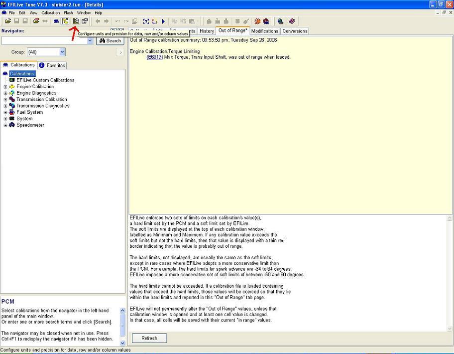

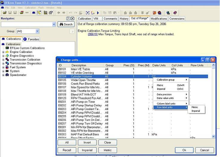

hey justin (or any efi guy)
so for example, on the spark table, I want to put the rpm on the x axis and the g/cyl on the y axis, how do i swap them. ANd how do you convert/conversions the temp stuff, like ECT celcius to Far?
not sure how to flop the X and Y axis but here is how to convert units....
Attached Thumbnails Knock knock.... who's there?  KR-1.jpg   Knock knock.... who's there?  KR-2.jpg
That, you can't do... the Log configuration is what I was talking about (since he posted up log shots).
All units are configurable (metric/imperial, AFR, IFR, etc), but in the tune tool it's not configurable.
If it really bugs you that much, you can highlight the whole table, copy with labels, switch to the default window and choose "Conversions" tab. Hit the Create new table button, then hit transpose, and it'll flip the axis for you and you can view it there...
