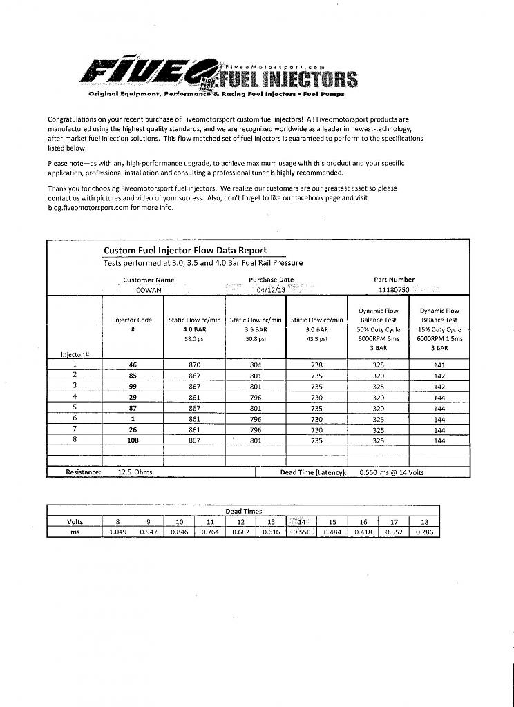

Thanks subeone. Now the info I got is only one line would I put it in the first row from 8 volt to 18 volts and then smooth out from there. Or interpolate. Here's the sheet that came with my injectors.
we are not entirely sure at what kpa the latency was calculated, so anything after that is guesswork. the best bet would be to put those in the last kpa column and interpolate after that
