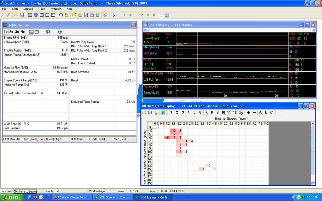

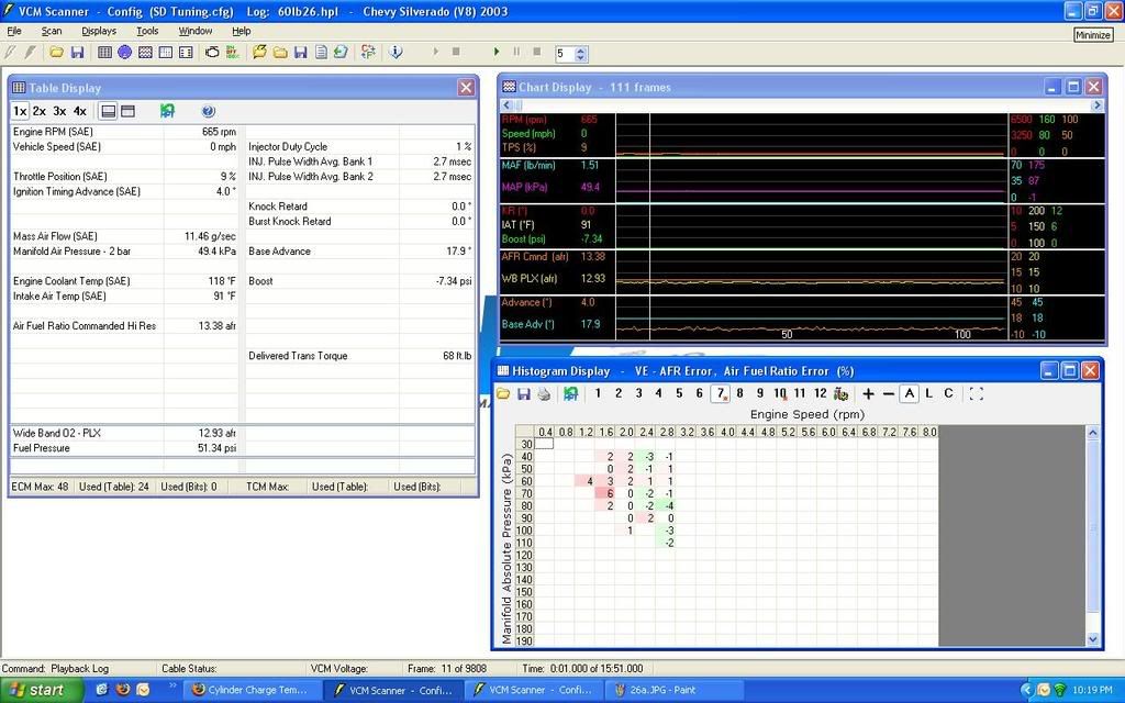

Frustrating. The last time I tuned my VE it went much easier. Here are screen shots of 2 logs. Nothing in the tune changed. First is a log of a run to town to gas up the truck. Get to the gas station. Stop the log. Fill up. Take off and log the same route back. As you can see on the trip back averaged about 6% leaner than the trip up.
WTF? Bias issue? The gas?
Trip to station.
Return trip.

On a warm-restart, heat soak is a big issue for the stock IAT sensor in the radix.
I purchased a new thermistor for my IAT from Omega, just haven't had a chance to install it yet. Supposedley, it recovers significantly faster.

I remember reading about that IAT sensor once upon a time. So basically it is a heat soak issue and the bias? Looking at the logs the IAT was higher on the return trip.

It's not really the bias, just heat soak. Air coming into the engine is cooler than either the heat soaked IAT sensor or a biased measurement using IAT+ECT can measure, causing it to run lean.
