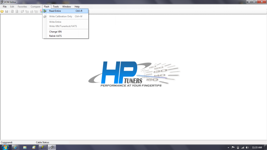

This part is throwing me off, you hit the read entire calibration command in HP tuners on your laptop, not the interface cable

"Read Entire" under the Flash tab.

Ok i got the drivers downloaded but with i push the button begin it says complete until it get down to security access and then it says denied.
sorry im was doing that wrong i was confusing myself too. but now its having a problem with security access.

Thanks guys for your help I found out that i needed to unplug my wideband. but it worked
