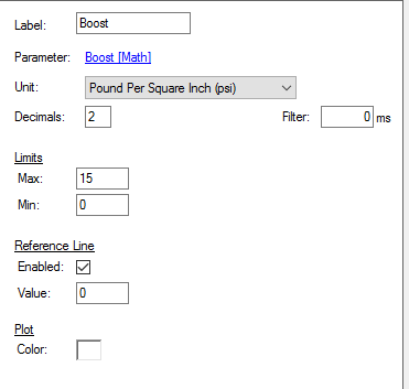

Since it took me forever to find this, I'm sharing the info.
There are 2 requirements:
1. Log "Manifold Air Pressure Sensor" as a channel (on the left).
2. Log "Barometric Pressure" as a channel (on the left).
From there, it's simple.
1. In your gauges, charts and histogram, go to the layout of each and add the parameter "Boost[Math]" and set the unit to "psi" and however many decimals you want.

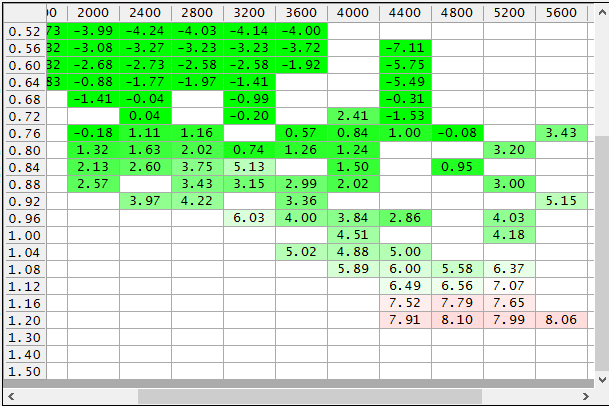

For the histogram specifically, I've got "Boost[Math]" logged against "Engine RPM" and "Cylinder Airmass" (scaled to 1.5).
Gauge
