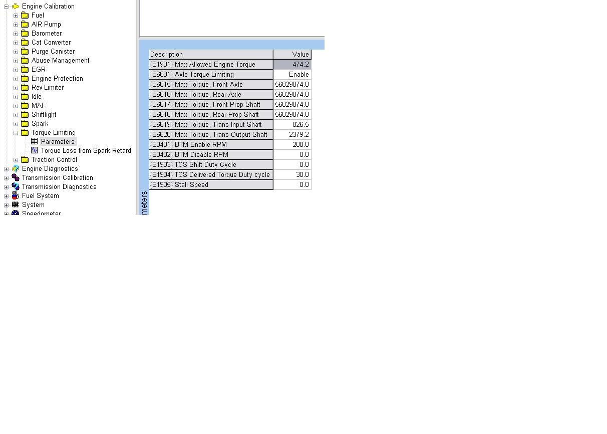

I think you can leave all the B12XX's alone unless you are totally disabling TM.
B1209 is just how long the PCM waits to shut down abuse mode after you stop driving abusively. You can probably ignore or disable the TC stuff if you don't have it.
Might want to go over this section if you have it in your cal:

that pic is a lil blurry. but i can make a lil bit of it out.
Also. what is Transmission Mode? and Upper and Lower thresholds?
