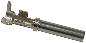

Alright. Well I went wrecking yard shopping and got some connectors for the ISS sensor. I thought I got the right connectors for both ends, but it turns out, the ECU pins I picked up were incorrect.
So I've been googling for the right pins.
Do these look correct?
Pico 5966PT 16-18 AWG Deutsch / Wedgelock Connector Female Open Barrel Terminals 5 per Package:Amazon:Automotive
http://www.picowiring.com/pdf/Cat-32.pdf
