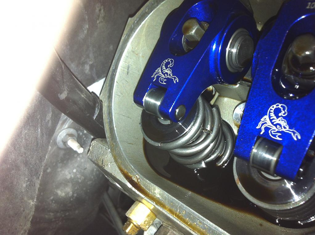

Yes springs have been changed....Jason said i would not have to get it retuned after valve spring change. but it was doing this before the valve spring issue on the dyno..

Some of the springs broke? Some of the springs don't just break unless there is a serious mechanical issue.
More details on your setup please.

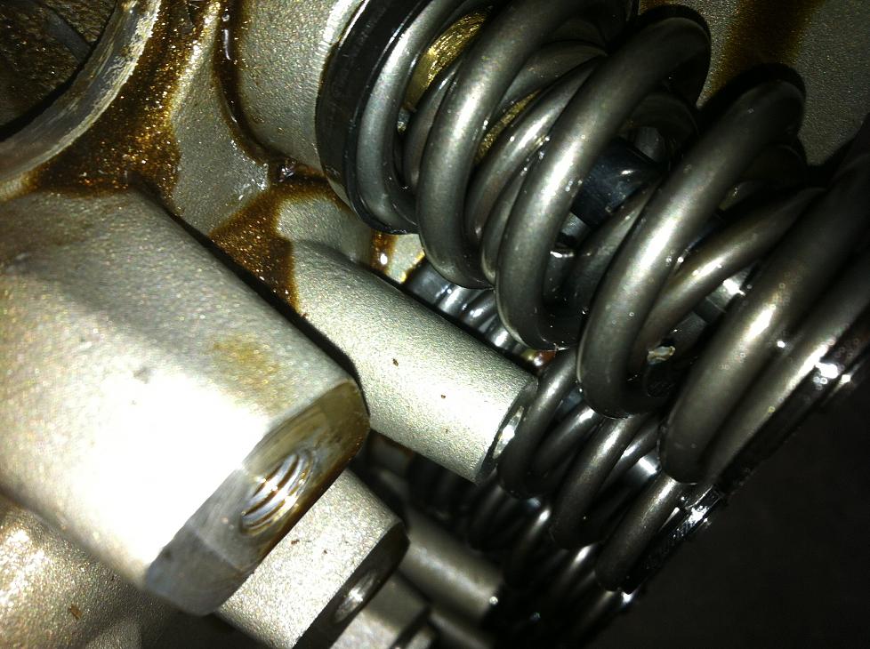

Im just telling you what happened.. How or why they broke I dont know... The guys at H&H in Haltom City didnt know the reason either the only thing they found was the retainer was bottoming out on the Valve Guide. so they cut the valve guide down .180 and ALL the valves checked out ok..And they put beehvee springs on. The springs that were on the heads were for a .580 lift cam i have a .581 lift and .001 is not going to break a spring. So the heads are fixed..
