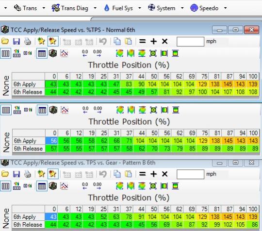

this is how i have my tcc setup as far as mph.
i had the 1st 3 tabs adjusted and it wouldnt lock up right away. never went back to change the 3rd tab back to a lower release mph. so this tune will be tested today when i head to the gym.

Nope still bucks bc the converter is staying locked. Im raising the 0% up to 54mph an 55mph try it then go from there.

No bucking on decel with it set the way i have it at 0%
6hrs of smooth driving
