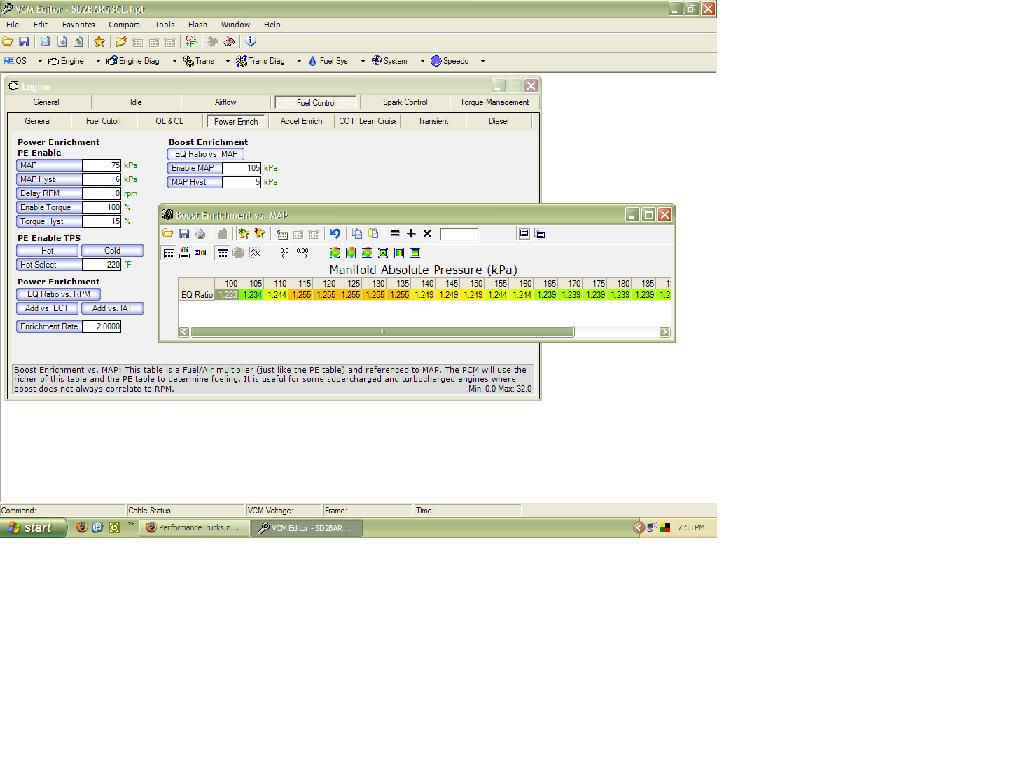

Only available in the 2bar OS. From the help file
"Boost Enrich: This table is an Equivalence Ratio (just like the PE table) and referenced to MAP. The PCM will use the richer of this table and the PE table to determine fueling. It is useful for some supercharged and turbocharged engines where boost does not always correlate to RPM."
Yeah, I mean how is it configured? is it a single column table? Or a complete RPMvsMAP table that you define fueling on?

Its a single column. EQ ratio vs. map. Starting 100KPA -> 210KPA in 5KPA increments. Posted a screen shot above.
